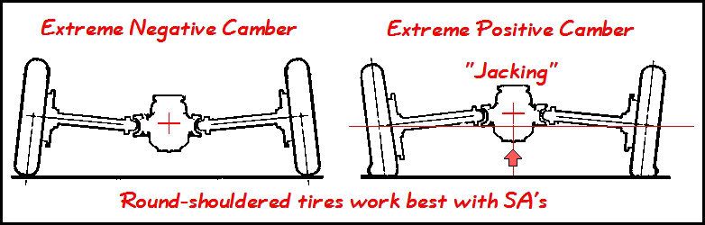

Most VW people know the basic problem with the swing axle -- it "jacks" in sudden fast turns, causing the tires to run on the edges, breaking adhesion, and you can oversteer right off the road.
Add an aft weight bias that needs all the rear tire adhesion it can get in a turn, and the swing axle Porsche's and VW's were oversteering cars.

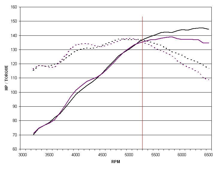

You want the engine to stay in the "power band" which is apexed in the RPM range at which the most torque and power is made. When you upshift, watch your tach. You may see a 1500-2000 RPM loss and you want to stay within the band.
Above: A modified 356 Porsche engine producing max power and torque at about 5200 RPM. A stock engine would apex at about 4000 RPM. The power band for this engine begins about 4000 RPM and drops off after 5500 RPM. The best shift point for this engine is 5200 RPM.
Which is why we want to build engines with as wide a power band as possible. This conflicts (of course) with the nature of high performance engines. As they get more powerful, the power band narrows, and moves up the scale. Some highly tuned engines have a 1000 RPM band at 6000-7000 RPM. They dyno great but are not streetable.
Street engines are designed to have wide, "flat" (little or no peaking) power bands so drivers can be in the wrong gear and still putt-putt around town. Wide ratio gearing is also common for street cars. VW traditionally had 1st and second as close mathematical steps, so that the upshift from 1st to 2nd lost little engine RPM. The worst gap was between 2nd and 3rd, and then the next gap between 3rd and 4th.

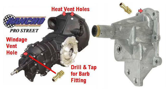

Venting & Cooling the VW Transaxle
VW transaxles have no provision for cooling, except by conducting heat out via the magnesium alloy case.
Porsche 917's had pump-fed oil to keep their transaxles alive, plus an oil cooler! That's because racing trannys get hot, especially for road racing. Even back in the 356 days (on various models) Porsche provided for cooling by casting an open slot vent atop the bell housing for clutch heat to escape, and fitted a mushroom-shaped windage vent to the transaxle.

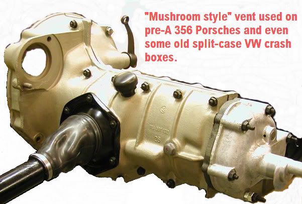

The vent on the stock VW is a single too-small hole in the nose cone (often closed by dirt!), and is critical. High internal pressure in the "front" of the transaxle case (opposite the bell housing) impedes the splash lubrication reaching the forward gear shaft bearing.
If you'll remove your nose cone and drill and tap the existing vent hole for a quarter-inch ID brass fitting, you can attach a length of fuel line to it, terminated by a reversed fuel filter. This allows pressure out but stops dust from coming in.
Air-cooling holes can be drilled in the top of the bell housing -- and don't forget a couple in the bottom to let cool air in.

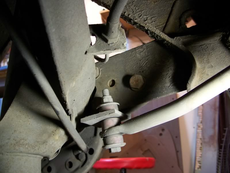

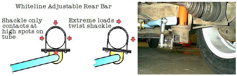

IRS Sway and Torsion Bars
We use a nonadjustable 19mm rear bar, or an adjustable 22mm Whiteline rear bar, and sometimes, no rear bar at all. It all depends on the track. A rule of thumb is the faster you go, the less oversteer you want, and on our type of car, rear bars promote oversteer.
As we got faster, upgrading from a 1.6 to a 2.2 liter engine, high speed handling became more and more important.
Above: nonadjustable bar.
Above: Whiteline Rear Bar with end links.
The front bar affects the rear bar and vice versa. This is called the "X-effect" and means loads from the right front wheel affect the left rear wheel, etc.
VW's and Porsches tend to lift the inside front wheel while cornering hard, which means while it is in the air, you have one whole tire that is not providing traction or steering.
All else being equal, a rear bar tends to keep both front tires on the ground. The heavily loaded outside rear tire, via the X-effect, transfers loading to the airborne front inside tire.
The thicker a sway bar, the more roll resistance it offers. But more is not always better. Porsche learned back in 1959 that decreasing the rear roll resistance made their cars handle better. VW followed suit on this in 1967 with softer rear torsion bars.
This means for road racing, the stiffer rear torsion bars intended for dune buggies are not always desirable. Good stock bars, indexed for the ride height you want, are best.
The only reason to have stiffer torsion bars front or rear is to resist bottoming out on very high speed dips, or on fast, banked tracks. If you race a lot under either circumstance, a slightly stiffer torsion bar is a good thing.
Hard springing (all by itself) is not the way to tune handling. You want to get your roll resistance from sway bars, and keep your tires planted with good shocks.
Coil-over shocks with adjustable spring rates are the easiest (and most expensive) way to tune your suspension. Coil-overs can replace torsion bars totally, if you want to go that route. And the results are superior. For instance, you can stiffen the front roll resistance via the springs and use less front sway bar, and then (with no rear bar) begin to adjust the rear roll until you have exactly the amount of understeer you want at high speed.

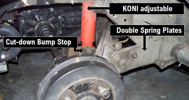

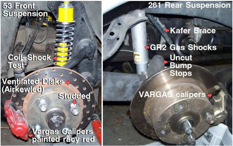

Above: This view (from our IRS Ghia) shows how to cut down your bump stops for increased rear suspension travel and our 3-way Koni adjustable shocks in place.

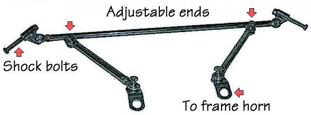

Kafer Bars & Other Reinforcements
The Kafer bar (Kafer being the original German nickname for the Bug) is an easy to install triangulation device that braces the shock tower uprights to the transmission mount. Wheel hop (caused by flexing) is usually totally eliminated by the Kafer bar. As is frame horn welds cracking. The Kafer bar works as well on a swing axle as it does an IRS.
The alternative to the Kafer is to tie the frame horns together with a solid steel brace, and strap the transaxle down front and rear. We used the Kafer on 261 and the bracing and strapping on 53. We know the braces/strapping work on 53, because in our autocross days, with our drag-race starts, wheel hop was never an issue.

The VW suspension, swing axle or IRS, has no anti-squat to counter acceleration, and for that matter, no anti-dive to counter hard braking. If you lower too much, and you have even a low-profile deep sump, you are going to bump it against the road on hard acceleration.

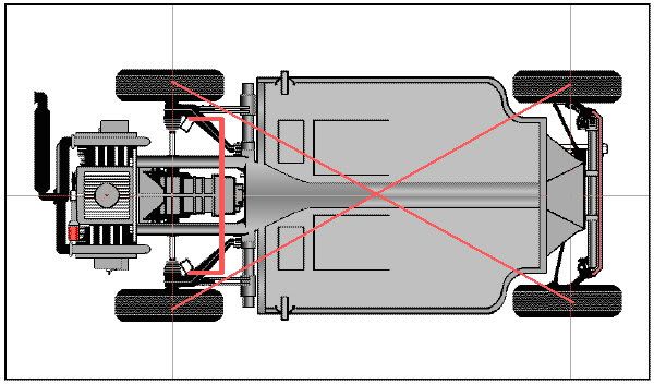

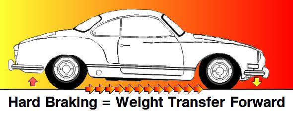

BRAKE BASICS ON REAR-ENGINE CARS
The rear-engine car, with more than half its weight in the rear, has a distinct braking advantage. As the weight transfers forward in braking, all four wheels are loaded, making the rear brakes work harder than on a front-engined, front-heavy car.
Even though rear-engined, in hard braking, about 70% of the total VW or Porsche braking effort is still borne by the front brakes!
Front-engined cars obviously overwork their front brakes, which might explain why the Ghia can get by with proportionally smaller brakes all the way around, than say, the Mustang beside it. Smaller, lighter, brakes mean less unsprung weight as well.

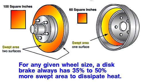

THE SWEPT AREA
Also, with the Ghia being a light car to begin with, the factor of "swept-area" versus weight comes into play. The swept area is the friction area on a disk or drum that contacts the brake pad or shoe.
Generally speaking, the larger the swept area, the better the brakes work. Disk brakes have an advantage, as they have a swept area on both sides, whereas drums are considered to have a single area, even through there are two shoes.
VW's have a very good swept area to vehicle weight ratio, in fact, falling even today into the performance brake range. Actually, a 1972 Ghia, box stock, could stop in a shorter distance from 70mph than a 911.
The problem was in constantly repeating the stop, and increasing braking efficiency over 70mph. Which can be done.

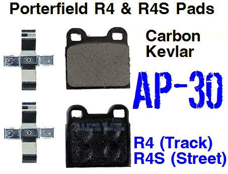

The answer proved to be Porterfield carbon kevlar Pads.
http://www.lpiracing.com/livper/porterfield_1.html
R4 is track only. R4S is for street and light track.
These pads alone fixed the fade problem. No matter the track, from the high-speed Road Atlanta to the tight, brake-intensive Barber Motorsports course, we never experienced fade again. Stock master and slave cylinders, rear drums, shoes, and all.

Above: VARGA calipers can be painted racy red if you have the time and a sense of humor. The four-wheel disk brake kit for 261 came from Joe Chirco http://www.chircoestore.com and got our Carrera drivers Barret Camper and Justin Broughton home alive from the 8000 ft. mountain road races.
An important side note is there is a possible complication when installing a disk conversion on a swing axle VW. Remember that on a swing axle, the axle tube is rigid and the brake bracket is bolted to the hub. But, the axle inside the axle tube moves in and out slightly.
Now, your rotor is fixed to the moving axle, and your caliper to the rigidly mounted axle hub!
As you drive, the rotor can shift in and out just enough to pound the pads back (termed knock-back), and when you step on the brakes, you will have to pump them a couple of fast exciting times to make anything happen.
The fix for this is to limit axle travel by shimming the axle bearing "float." Joe Chirco advises this:
The rear axle bearing float needs to be minimized while maintaining sufficient compression on the caliper bracket. There are two ways to accomplish this. One method is to shim the bearing to the correct float. The other method is by machining the bearing retainer cap to size. Some disc kits come with various thickness bearing shims and will function just fine.

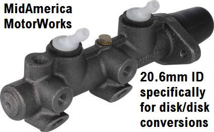

MASTER CYLINDERS
We run a stock Ghia master cylinder, and it works for us. We've used both German and Brazilian, without being able to notice any difference. Of course, remember 53 is a race car, and gets its parts replaced more frequently than a street car, so the durability differences between parts sources does not always affect us in the short term.
The VW dual-circuit master cylinder for disk/drum is 19.05 mm inside diameter. The early 911 m/c was 17mm. Lots of guys have swapped later, larger 911 m/c to VW's because they bolt right up, expecting better braking.
But all a larger inside diameter m/c does is pump more fluid, and (if all else is equal) that means you have to press harder (yes harder) on the brake pedal to get the same amount of braking force. Installing a larger ID master cylinder is justified only when using different calipers with different piston sizes that require more fluid to activate them. That leads us to this:
For four-wheel disk brake conversions do get the special disk/disk m/c offered by some parts houses. We have one on 261. Be aware than unlike drum brakes (and this is a simplification), disk brakes require a little residual pressure to keep the pad just barely in contact with the rotor, and the valving in the m/c provides this.
http://www.mamotorworks.com/acvw-1-0-4690.html
The master cylinder pictured here is from Mid America Motor Works and is 20.6mm ID, to provide for the extra fluid disk calipers require.

Lots of companies offer front and rear disk brake upgrades. Airkewld, run by Pete Skiba, has some of the best brake kits.
http://www.airkewld.com/pages/welcome.php
Pete provided our studded and cross-drilled rotors when we replaced the Sebros, and offered his best Bad Brakes kit for our Carrera Panamericana Ghia, but we stuck to VARGA caliper for both 53 and 261. Our decision to stick close to stock was simple. No doubt Pete's brakes are ultimately better, but our brake combo has been working great and we haven't yet reached its limit.

By the way, we ran Porterfield R4S pads on 261's front rotors and stock pads on the rear. Worked great.
CROSS-DRILLED ROTORS, DRILLED DRUMS
The holes in disks or drums are not just for cooling, as they might appear. Mainly, they release the gasses created by superheated brake pads and shoes. These gasses act as a lubricant boundary layer between the brake friction material and metal rotor or drum. Our rear drums were drilled by http://www.chtopping.com
Our Herbie never had drilled rear drums.
Our drilled Ghia drums have worked great, and the reason I kept rear drums on the Ghia in the first place was it started competition life as an autocross car, and I wanted an operational handbrake. Drilling the drums were an experiment that worked, and while I do not feel the need to change over to rear disks to improve braking, I intend to eventually change over for easier brake service and inspection at the track. Track cars don't need hand brakes. 261 didn't have them, and it survived Mexico on plastic wheel chocks.

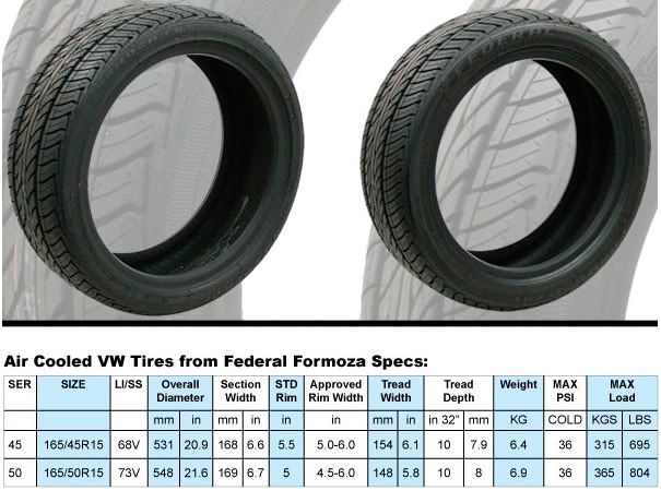

45 and 50 series Federal Formoza VW tires sold by http://www.cip1.com These tires are very low profile, just 21.6 inches diameter for the 50 series, where a standard 165x15 tire is typically 25 inches diameter. Running the lower profile is a dramatic change in overall gearing, with the effect of having a much lower (less top speed) final drive gear -- not to mention lowering your ride height by 1.7 inches.

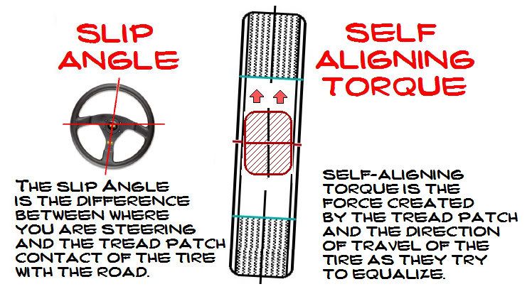

Tires have "aspect ratios" or series (the height of the sidewall relative to tire width) that greatly affect how the tire responds. The classic old bias-ply tire VW and Porsche 356 came with was a 70-series tire. Very low aspect ratio racing tires go down to 25-series. A 50 to 45-series tire is considered low today for a street tire.
Good things about low profile tires is with less sidewall to flex, the tread patch follows the main carcass of the tire more accurately, and the slip angle is reduced. This makes more responsive handling. Also, a low profile tire tends to have a larger tread patch even if mounted on the same wheel as a previous high profile tire.
Lots of slip means steering response is slow, as the tread patch and tire carcass get in line with each other. Self-aligning torque is the force that accomplishes this.
A bad thing about low profile tires is the larger tread patch (given that the vehicle weight is the same) tends to hydroplane at lower speeds. Also, higher profile tires allow more cushioning on bumps and act as part of the suspension. A pothole that a higher profile tire might bounce over can burst a low profile tire.

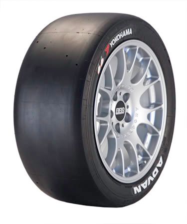

A true "slick."
RACING SLICKS vs RAIN TIRES (and why do tires squeal?)

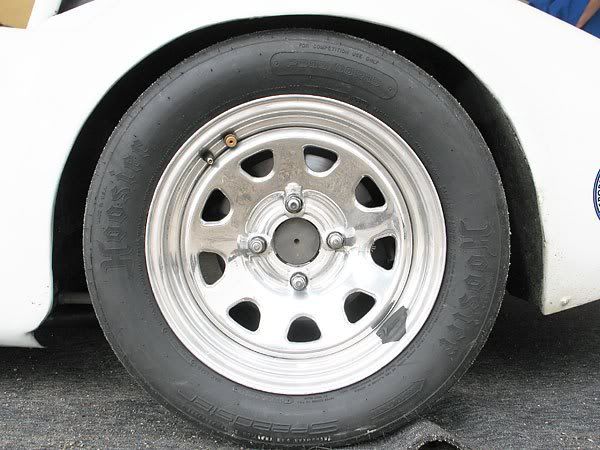

The tread pattern on a tire is intended to disperse water. This is the Hoosier Speedster racing radial currently used by vintage racers.
Sometime in the 1950's, the slick (no tread pattern) racing tire was developed. The first slicks were for drag racing, and by the 1960's were being used in road racing.
Slicks provide more traction because they put more rubber on the ground compared to the same tire with a tread pattern. The downside is slick tires can't be used in the rain, which is why worn street tires (usually described as bald) are dangerous.
Tires with tread squeal when cornering because the tread blocks rub together. Slicks don't squeal.
