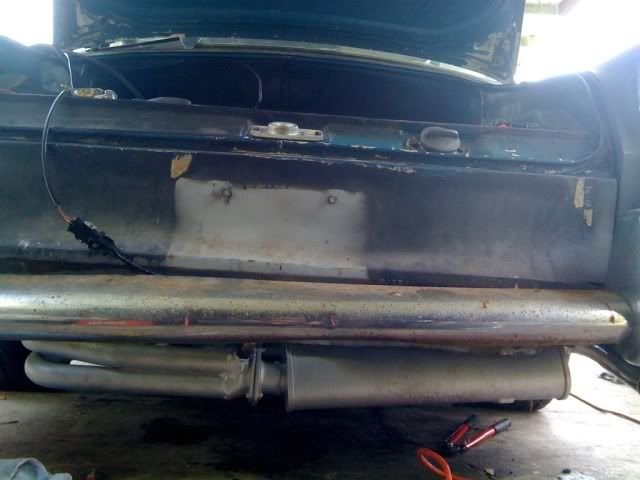

Teaser alert, cover small childrens eyes, it might get a little R rated
I'll post a real update, to include: written words, lots of pictures, and a video of it running (knowing me it will probably be super goofy too). I'm deeply sadned to report that me and Google have gone seperate ways and that is why the blog is down. When I have some more free time I'm going to make newer and better one on wordpress.

so a little update...it runs! I was wondering if all the extra components that I had leftover from assembling the megasquirt were important...turns out they were, who would have thunk it?

I must have been smoking some funny cigs because 3 diodes weren't installed, u4 wasn't either, and r6 was missing too. The real funny thing is I had u7 still in its sealed baggy, "I wonder if I stuffed u4 into the u7 socket?" hmmmm, yup sure did. Even with my suicide terrorist sabotage attack, it fired right up. Now my engine just needs to survive the tuning learning curve then i'll be golden.
Fridays mission is to change the oil, check/adjust the valves, check the timing, get the alternator working, and make the "Nate" bellow adapter. Should be road ready this weekend, that gives me 2 full weeks to give her a good shakedown...plenty of time.
