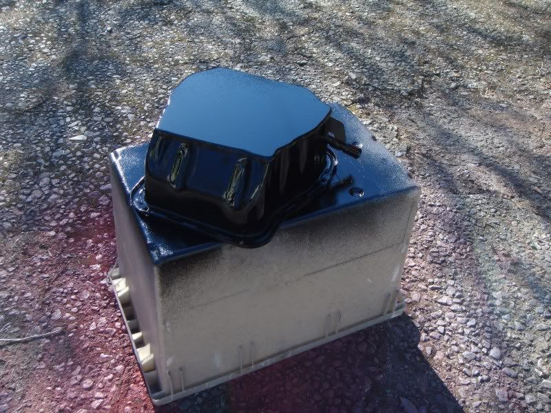

Question re the oil sump alterations. I plan on using the stock pan but want to cut it down. Outfront quote:
The easiest way to do this is to chop off 1 1/2" of the pan on the bottom. Since the original design of the motor places the oil a good distance below the crank, when using our chopped oil pan the motor still accepts 5 quarts of oil with no risk of oil aeration. If using the stock dipstick, the full mark becomes the low mark with this cut pan. The bottom of the pan is about 10 3/4" below the crank center. For those doing VW motor replacements, that's about 2 1/2" lower than a stock VW pan.
If you cut it down and reduce the volume then how will it still hold 5 qts?
Also when cutting the pick-up what's the best way to achieve this? Do you cut it down on the upright and the angled part?

Hey Panel. Looks like we are using the same engine! I never found out out what mine was precisely because the barcode on the timing covers was worn off. Regarding chopping the sump. I think I cut 2" off the bottom of mine and I modified the pickup just like the one you have pictured. I modified the pickup to be about 6mm from the bottom of the sump. I also used 1/4" plate so it will takes some bumps. If I remember you van is quite low so you may also want to do this. "TD04 turbo is off" is this hinting at something?

Thanks for the pic and specs. The TD04 is just off the OE exhaust, just to relocate etc. Really just stripping unwanted parts.... sure seems like a lot of scrap metal I have now. Lots of weight reduced :wink:

i do know they have you send in yours (which yours will be a turbo oil pan with the notch ) and they will send you back an NA pan thats been chopped and a new bottom plate installed in the same manner vw1303 has done his. so this in effect does maintain volumn because that notch is no longer there. now if you were NA and got a chopped pain it would not be the same volumn unless you essentially overfilled it and then you'd get oil splashing against the rotating crank i would guess.
also, while youre playing with the pan, think about the turbo oil return, if you are relocating it, you'll want to put an -8AN male bung in it now. just as a side one, don't locate the actual turbo too low otherwise you'll need a scavenger pump to evacuate oil from the turbo. im sure youve thought about this but just thought i'd throw that out there
oh, and while your in there, closely inspect your pick up, they are notorious for cracking at the flange and then there goes the motor as it sucks air.
