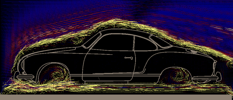

Very interesting. From the unscientific air flow models I've done, the ghia is showing great laminar flow across the rear end. I was thinking about doing the exact same thing (closing in the deck lid) _but_ moving the vents to the rear end of the deck lid. In the models I've created, moving the deck lid vents to the rear (vertically on the rear end portion) of the deck lid makes a huge difference in the engine bay pressure. The venting also seems to help smooth out the rear drag as well even though it's fairly clean to start with. The only downside I can think of is that at very high speeds a spoiler may be required.silkvw wrote:Great post! I've been thinking about what will really work to improve the aero of my Ghia too. So far, I have covered the air openings of the deck lid with a piece of aluminum, cooling air is drawn from under the car with a 4" dia. duct (dryer vent) and intake air to the turbo is taken from the passenger side 1/4 panel air box that draws air from under the car. This set up has worked at 120, 130 and 140 mph. I have a gauge to monitor the pressure in the engine bay, it's always positive when the car is moving, but I don't know if there is enough air flow through the engine bay. During a 141mph, 1 mile run the oil temp was below 200 deg. and CHT stayed below 300 deg.
Also, is your car air cooled? And, do you have pictures of your air boxes, etc? Would love to see the placement (is before or aft of the firewall?). I've got a promising model that draws air from the transaxle area and vents through the rear of the deck lid as mentioned above. Your car may be the first real world example of this working.
here's a model I ran on the iPad (don't laugh

Thanks for the feedback on my project btw. Sometimes I get so focused on work, I forget the little things. :)silkvw wrote:How is air forced through your radiator, and where does the air go, after it leaves your radiator?
The plan is to have air come up from the transaxle area, flow through the radiator and vent out of the rear of the deck lid as discussed above. The laminar flow across the stock deck lid vent area is too strong to vent there. The models are showing really promising results with this method but we'll need to see what reality looks like.

I think you were reading my mind. I have some ideas sketched out around using the deck lid flow to catch "cold air" and to provide a spoiler effect for increased stability. The way you've done your car would work as well.silkvw wrote:I was just thinking, you will be "reheating" the engine with hot air off the radiator, unless the hot air is ducted to the outside of the car. However, what you're doing (with the space available) works with most front engine cars too.
