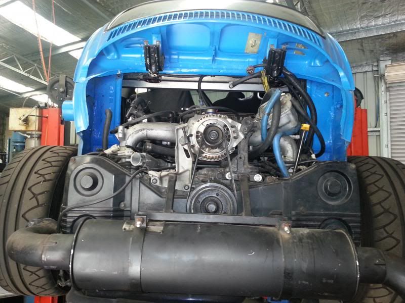

Hmmm from what I can find online, the dimensions of the motors.... is unclear to me.
Looks like the EJ22 is most compact, then the SOHC motors are about 29" wide EJ20 or EJ25, and then the DOHC motors are both 31" wide... which is the same width as the engine bay
IDK, all the information I can find is internet information and so all subject to being inaccurate. SO I suppose a DOHC EJ25 and EJ20 turbo are equally hard to fit and the SOHC EJ25 in theory fits with minimal issues. However, where does one get a SOHC EJ25? They don't seem to be a JDM throw away.
The only reason I want to go with a prevalent JDM motor is the fact that you can get them for $800 a pop with ~60k miles. Whereas all the local places around here want $2500 for a 150k mile worn down motor with no wiring or other parts and you probably have to do a rebuild.

You are right on on the sizes, EJ22 is smallest, then EJ25 SOHC, then the DOHC motors.
Jeff
He just told me he had a line on some motors and harnesses.
Tell him I sent ya.
Jeff

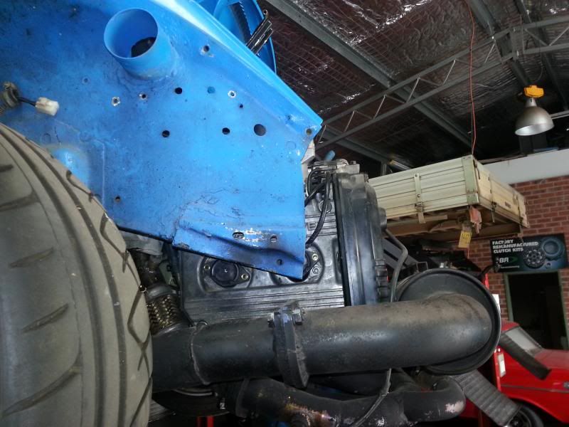

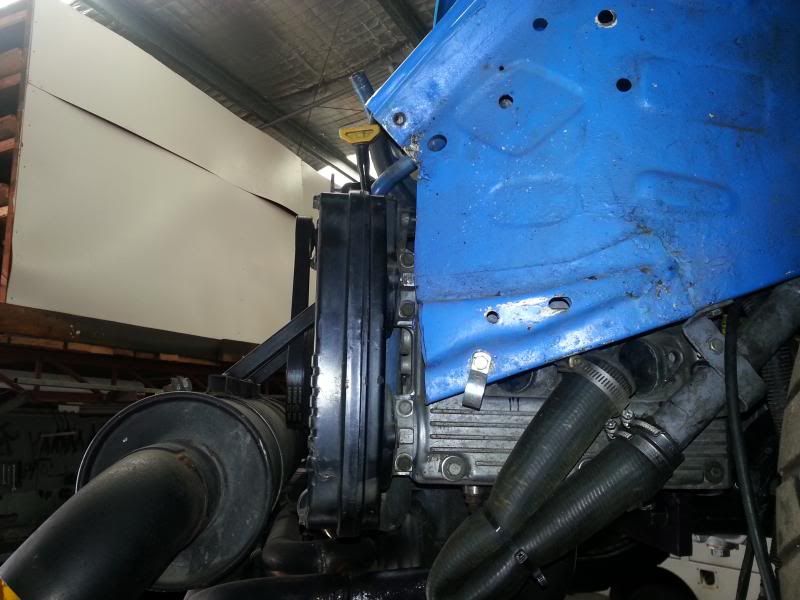

The EJ22 are the same size as all the phase1 EJ15 to EJ22 engines, which is same width as the VW engine.
The phase 2 SOHC EJ20 and EJ25 are wider, they still interfere with the bumper mounts in a Beetle but nothing like the DOHC engines do.
In Oz you can find the phase 2 EJ25 SOHC on 2001-2005 Impreza RS, 02 onwards Forester and 2000 onwards Legacy.
I don't imagine the states would be much different.

Yeah you can find them at junk yards, they just want way more than they are worth and usually have a lot of miles.Buggin_74 wrote:The EJ22 are the same size as all the phase1 EJ15 to EJ22 engines, which is same width as the VW engine.
I'm not scared of cutting stuff up and I am fairly solid at metal fabrication, so I think I can make a EJ20 DOHC turbo fit. It's worth a try to get what I want in there, right?

They can be made to fit by moving the trans forward but you do need to get creative if you want to run bumpers though.ryans88gt wrote: I'm not scared of cutting stuff up and I am fairly solid at metal fabrication, so I think I can make a EJ20 DOHC turbo fit. It's worth a try to get what I want in there, right?
