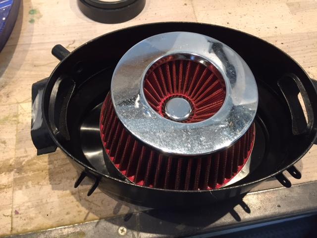

The solution with the central aircleaner will help you with dampen the intake roar. BUT the CB Turbo hats are far to restriktive! I made a central air cleaner system on my oxyboxer. I made my own carb hats from Epoxy/fiber with a 2” intake. The dyno showed, that I lost 10 hp because of the hats (I tried several dyno pulls to find out where the restriction was). You need the largest possible intake in your carb hats to avoid hp loss. And it looks like, the CB are rather small...

Are you using a stock oil-bath type cleaner?

Yes, it´s a modified stock air cleaner. I enlarged the snouts to 2" and installed a large KN style filter inside the air cleaner. It sucks from a hole underneath (where the carb used to sit).
After the dyno run, where I found out that the carb hats were restrictive, I redid the carb hats to 2,5". Haven´t tried them yet. I will give it a try in the future. (sorry about the pic size :roll: )
