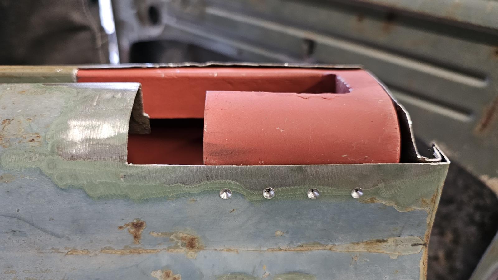

Oh. Complete forgot this thread again. Yes, the rear hood was basically finished in June. Car still in the barn at that time.
But I started working on restoring the split doors already in March. Also built a lot of Hebmuller specific parts for the doors.

Post by Hebster »
Lots of work before I even could start modification...

Post by Hebster »
Doors are not completely finished. Also decided to convert the front hood to pre-49 look with L-handle and lock as on read hood... So I needed to fabricate the inner panel for the handle and lock...
