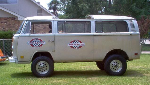

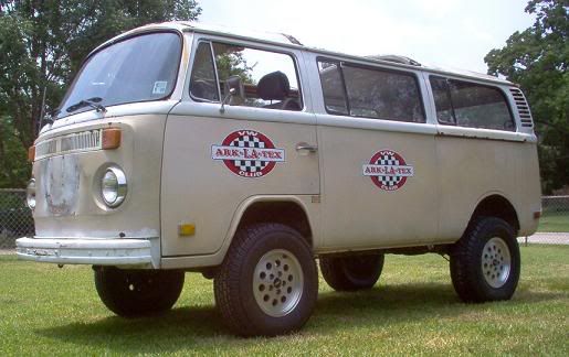

I've been working on the bus suspension lately. I installed the raised spindles finally...... This allowed for 30x9.50x15" tires to be installed on the front without any issues... I also put some 31x10.50x15" rear tires on. I can put my chin on the drivers door window scraper..........Why ..
.... I don't know.... thought it might give you some idea of how high it sets...... I'm 6'2..............or my hands were dirty at the time and i needed to scratch my chin.....
I am working now on the fenders to make it look right with the offroad Baja theme. I have aqquired a set of Jeep Wrangler rear flares that i'm modifying to fit close to the body and provide the protection i need and allow the sliding door to open. These aren't an easy task at all.........I have one side in pinned in place awaiting final assembly attachment.
I had to order some longer rear axles to compensate for the lift and track width changes. I can't wait to get this thing on the road.......
My biggest problem now is i have outgrown my floor jacks......
I have to use 4x4's to help lift it......

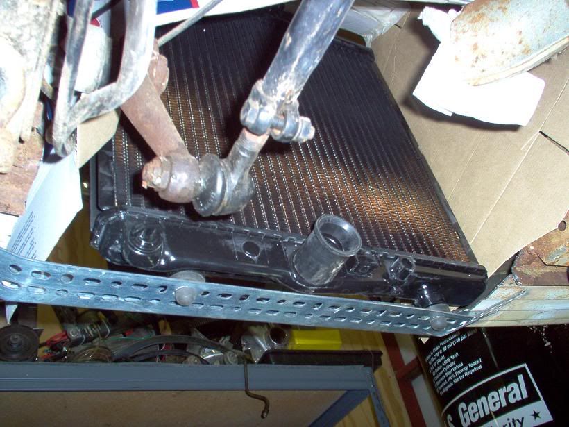

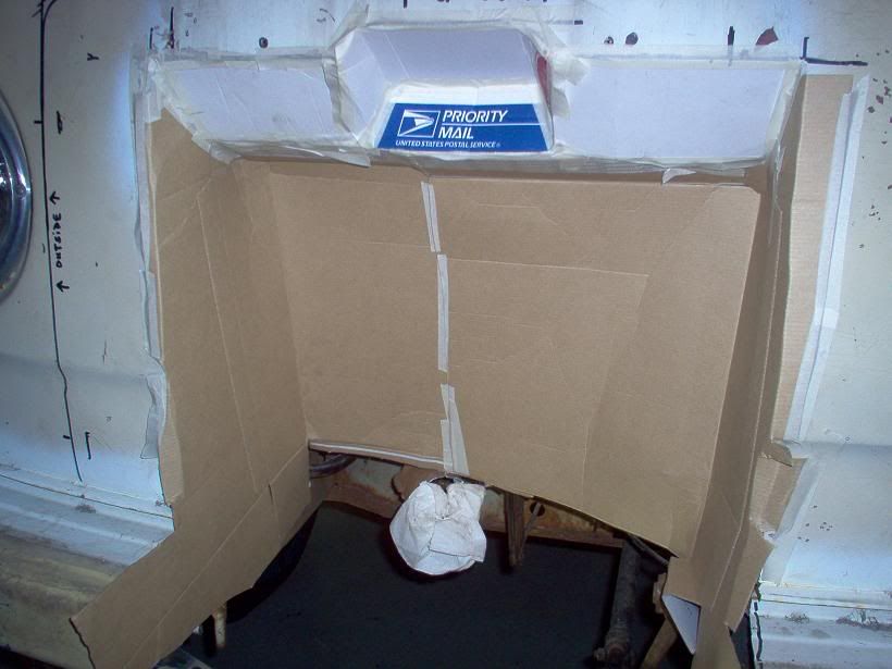

Well, I worked on the Radiator mounting today................... Man......I'd hate to have to replace a front clip on a Bay Window....... It took a lot of patience, Saw-z-all blades and blood,..
... cutting out for the radiator mounting....
I opted not to remove the air box up front. Vw put it there to cool me down and by golly i want it there......
.... I ended up removing the bottom 5" of the box at a angle to allow for the rad enclosure. After several blades and some blood i finished my cutting. During all the cutting I only cut 1 wire and my water bottle in half......
I hung the rad in place with makeshift hangars while I built a lower mount. I used Dexion (spelling) as it is very easy to work with and adds redneck truck flare to the front.....
I had to allow for the steering arm clearance on left turns by moving the lower mount forward 1 inch from my original plan. Now no interference ...
I also mounted the front bumper to check clearance with no problems.................On to the box work....
USPS helped me out with the templates....... I trimmed and fit a makeshift box behind the rad and it looks like plenty of area for the fan and to expelling hot air. I will channel the hot air rearward with additional metalwork later... Also i'll be installing a small airdam under the forward edge of the rad to aid in creating a low pressure area behind the rad and shrouding....
After all the metalwork is complete i'll seal the rad to the front body with some race plastic to force all the high pressure air though it rather than allowing it to go around..... Here are my Rad install pics....
http://s71.photobucket.com/albums/i160/ ... 0mounting/
I still have the metal work to do tomorrow maybe........ I'm a bit tired today.............

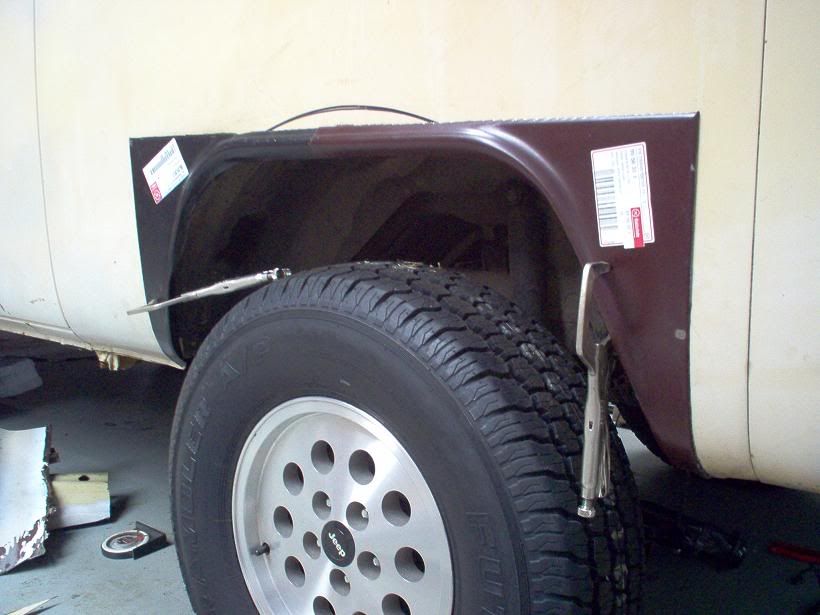

Today I hung out in the Monster Garage and worked on "Clyde"...... The bus as I have now named it..... I fired up the saws ,grinders and welder to try my hand at custom fender making.......
I took some front bus doglegs and made rear fenders with additional clearance for my big tires. What I wanted was a near stock style with plenty of room for my 31's I put on the back. I took left and right doglegs from a 73 - up bay window and trimmed and welded them together..........Now the rear fenders will match the fronts almost like they came that way......
Tomorrow i'll do the other side and do some finish work........
