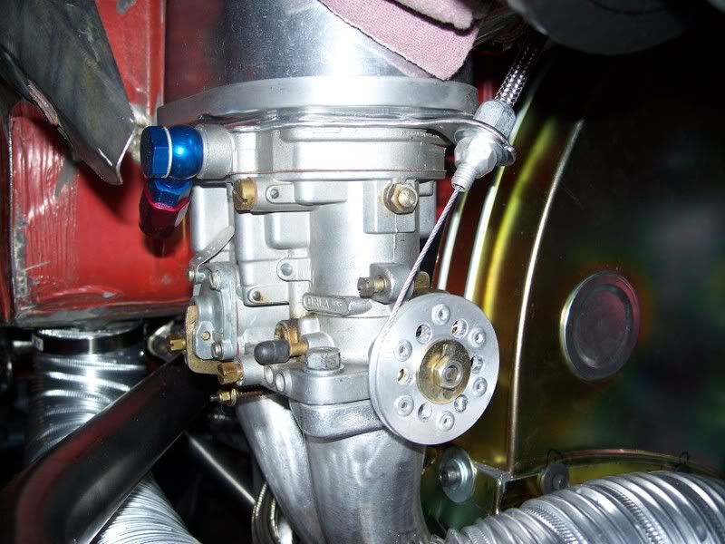

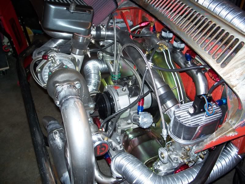

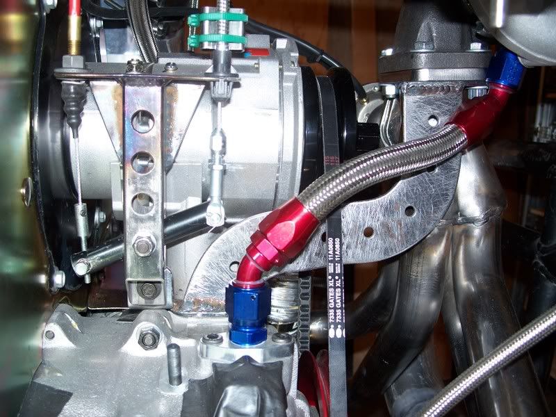

Wow! I really should check out this Type 4rum a little more often. You guys are definately ahead of the curve on a few areas :wink: . I've seen bits and pieces of Slowtwitch's awesome cable/pulley linkage in other forums, but I had no idea the real story is all in this thread 8) . I'll share a couple pics of my home brewed cable/pulley setup, even though it doesn't hold a candle to the workmanship and simplicity of the system slowtwitch developed. I hand made these pulleys by riveting 3 layers of aluminum together, then drilling and hand filing a bit. The cables are from a company called Spectre iirc,....cheap. The only ~iffy part of my contraption is the center pivot that ties the cables together. I'd like to support the pivot shaft better....in time. Otherwise it opperates smooth and doesn't require any additional return springs to snap back to idle. Oh, and it's on a T-1, sorry :oops: .
I made my stuff over 3 years ago, by the time my project is on the road I might just be on the market for one of these Sync Link kits :D . Really nice work and a very reasonable price. It's about time sombody marketed a better linkage for duals on these flat-4 engines 8) .
