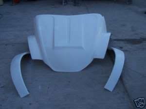

It looks like im going to be getting a new 1 peice front end. My uncle wants new rear fenders and I wanted a 1 peice so we are going to buy this kit from Baja Fabrications.
I cant seem to find a website for them, but they have ads all over the place. I found this one on Craigslist http://sandiego.craigslist.org/pts/268307154.html
After I get the 1 peice im going to trim my rear fenders down a bit too.
