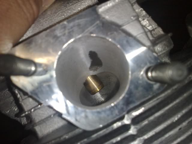

As a common practice for me, With a turbo build, I remove the part of the bronze guide that protrudes into the exaust port...Just my 2 cents
Hey Bender
how do you remove it?With a carbide bit? do you smooth it out flush with the aluminum?
Thanks for the tip
Hey Bender
Thanks for the tip
yep.......Flush....Had some problems....had some unwanted paraphernalia in the turbo.........
