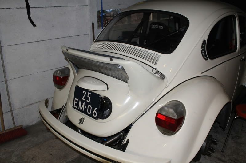

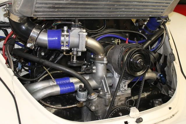

Was able to get a lot done this weekend :D
and everything fits under the engine lid!
Well, my engine lid anyways :lol:

Redid the throttle body: changed it for a Ford one and made it fit.

At 30-35% rotation of the butterfly, I was still on the idle circuit with the Mex TB...
The Mex TB is just not a performance item in my book. Its made for smooooth transitions. This Ford TB immediately gave me more respons and more usage of the TP-range in the map.
YMMV, but I like this much better.
