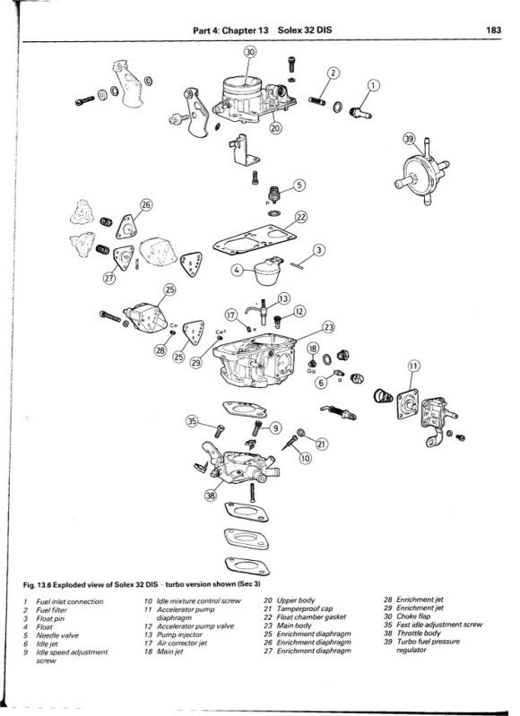

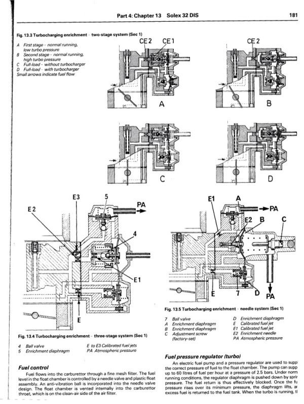

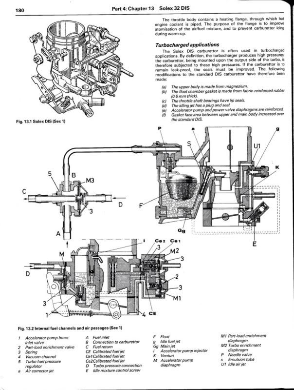

Clonebug
Posts: 4745
Re: my stock 1600 dp turbo build!
Post by Clonebug »
Never mind, I searched in yahoo.
Here is a link to a page that has drawings of the internals.
http://s149.photobucket.com/albums/s65/ ... 032%20DIS/
This will give you and idea how it works since you will need to become very intimate with that carb to make it work.
Here is a thread on it in STF.... not a lot of info but it's nice to see what others have tried so you don't waste time testing things others have done.
http://search.yahoo.com/r/_ylt=A0oG7ik7 ... %26t=44404
