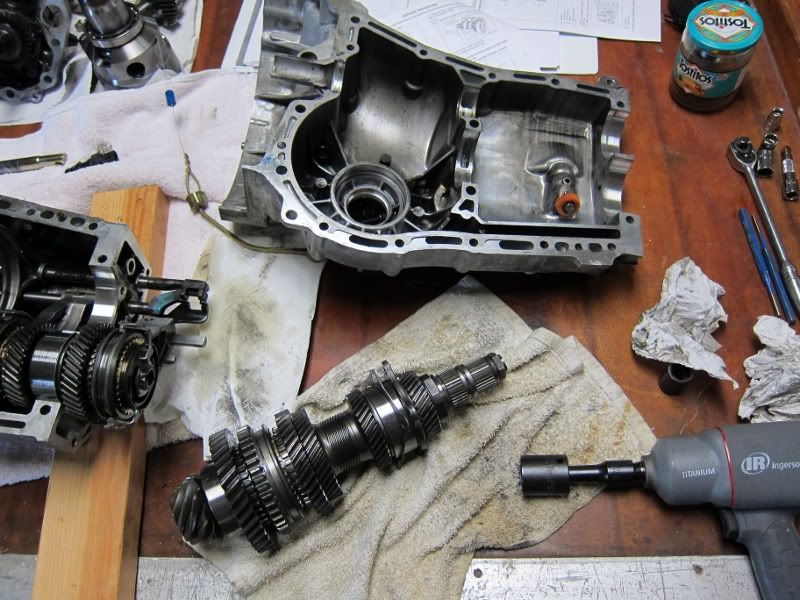

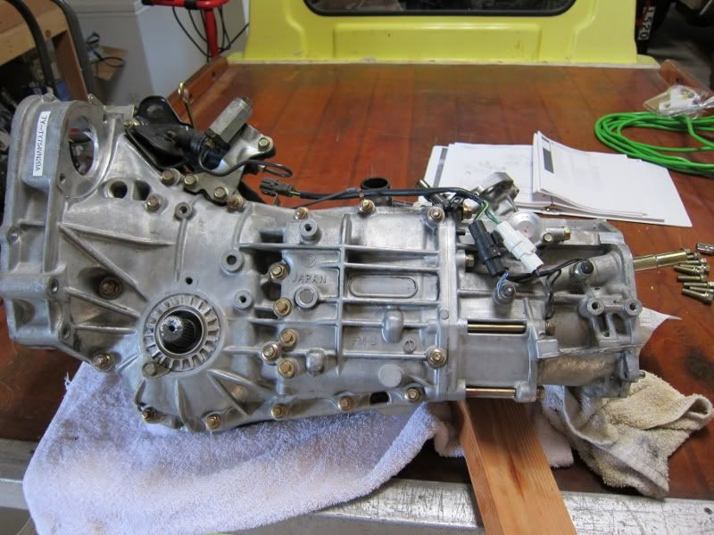

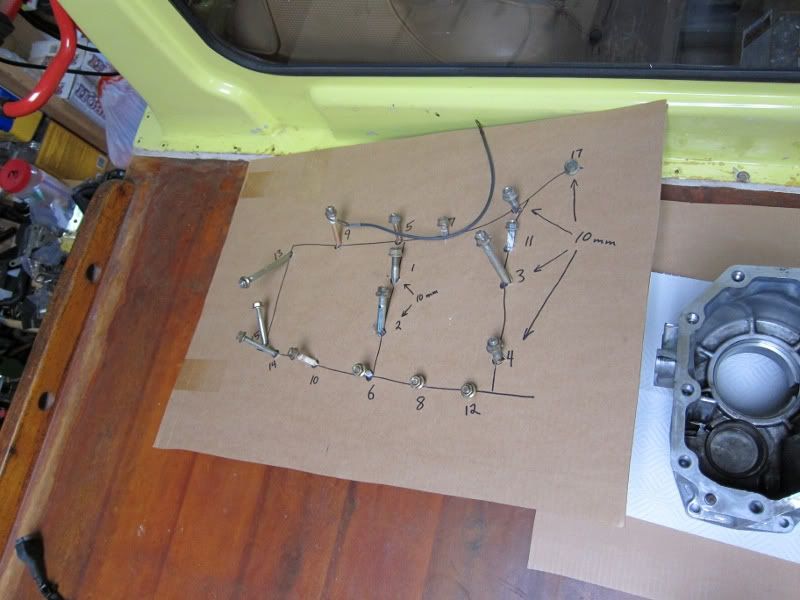

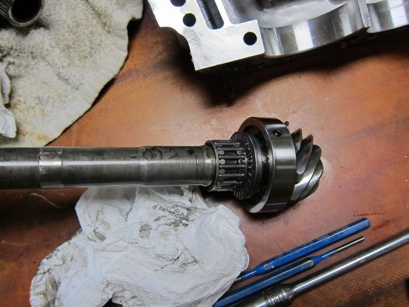

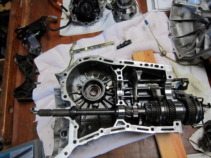

Cracked that puppy open (I was feeling really brave). Todd sent me a pinion setup tool, so I figured I would try to do this whole thing myself...

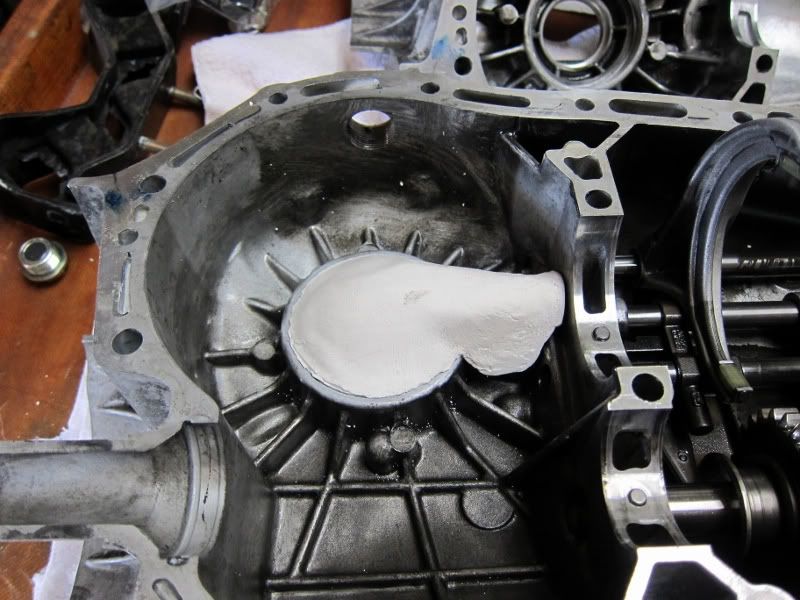

I made a "plaster" mold of the left case to use as a gauge to clearance the right case side.

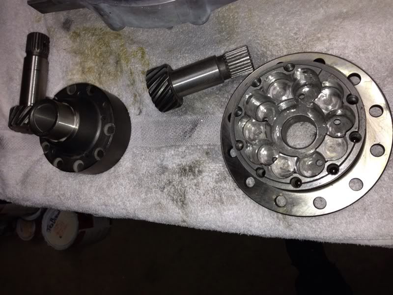

Oh crap...that one looks like it would be difficult to get to...you have to take off that huge nut to get to it.56SemaRag wrote:The double taper. The one that the shims sit on and has the four mounting bolt holes.

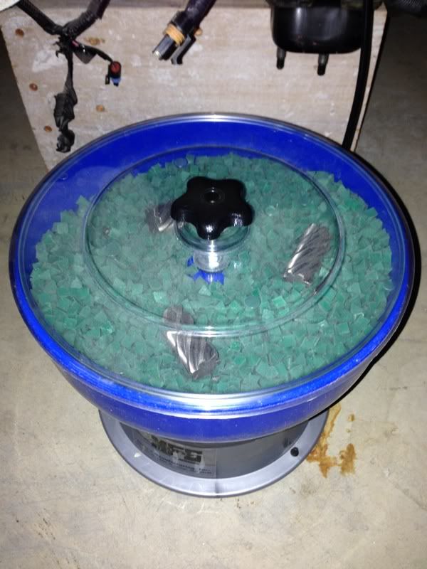

ShopTalk folks have the coolest toys.ambrynmc wrote:I even put the spiral gears in a vibratory tumbler for a half hour (need to go in for longer).
