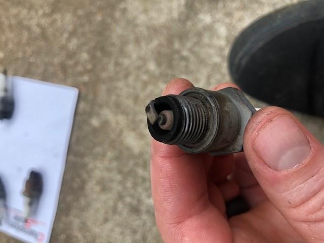

Wow, that's pretty bad.
I pulled mine this afternoon, and while I have never claimed to be able to read plugs like some people are able to do, these seem fine. Gap is ~0.29inch on all of them. I'll leave it up to an experienced eye though.

Posts: 4042
Re: MS3v3 System for CNP and EFI/Turbo "Beetle"
Post by Chip Birks »
Lower that gap to like .018 just for kicks

2 years?! Dang. I'm lucky if mine stay in for 2 months! That said, yours really don't look too bad to me. I'd say your tuned pretty well.
madmike
Posts: 3146
Post by madmike »
by the looks of them plugs your tune is purdy good :wink:
