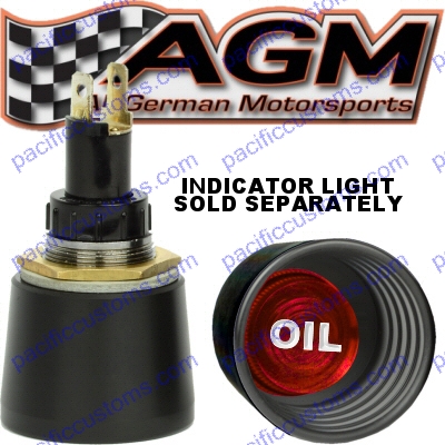

I think these are really cool. Bezeled, blinking, labeled and colored as you choose, and BIG. All the parts at Pacific Customs, maybe $40 per indicator, but probably very worth it.
