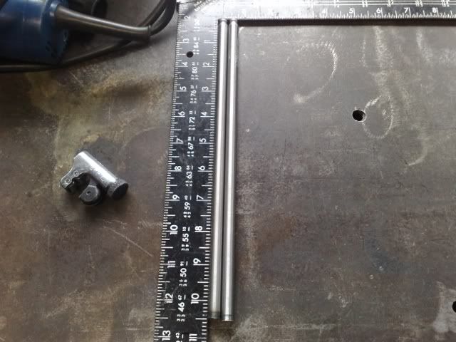

Cut my pushrods finally.Here's a few pictures. Too busy with work to test the lift again yet.
Set it up like turbobaja's with a few washers under the square.Cut with a pipe cutter and then filed to match lengths. Tried a grinder disc but it was a little harsh and hot.
