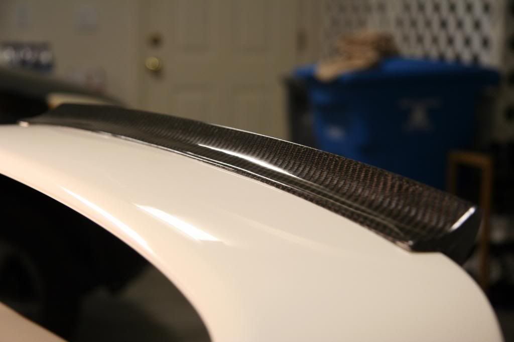

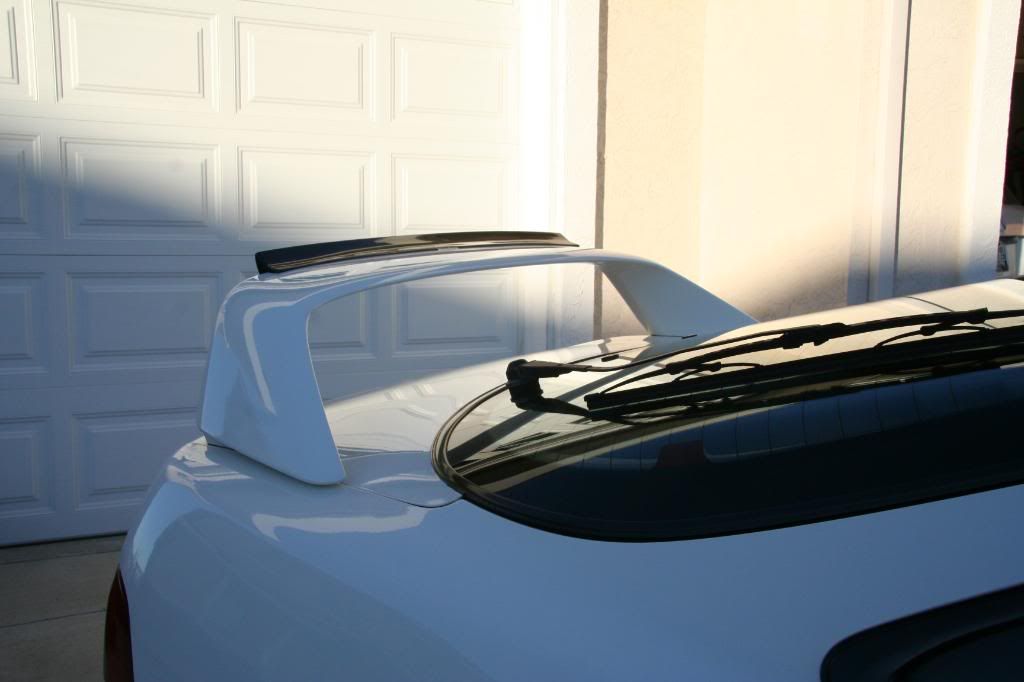

I've been browsing the web for ideas on a rear wing... now I see most wings have Gurney flaps at the rear in order to reduce drag. This seems limilar to the old kamei rear wing spoilers.
http://i203.photobucket.com/albums/aa31 ... G_9215.jpg
Has anyone experimented with the position of such a wing on the bug's roof? Obviously you need to get it in the right position to be most effective.
http://i203.photobucket.com/albums/aa31 ... G_9236.jpg

Hi 4AgeDub,
The addition to the wing is a Kamm-style spoiler lip. The wing itself in the photo is itself a spoiler that reduces drag but does not exert downforce.
A "Kamm tail" is flat, as if the rear of the body were cut off, and the lip deflects air upwards to (partially) break the vacuum drag that is created behind the vehicle.
You've seen the electric factory VW and Audi roof spoilers that pop up just above the top of the rear window. Those are small in size but very efficient. Audi TT's were in fact crashing in Europe because of poor high speed aerodynamics, and the roof spoiler fixed that.
They were kept folded and automatically deployed after some (I forget the specific number) low road speed was exceeded to reduce drag and keep gas mileage up. Porsche and Chrysler also used electric spoilers, but not roof mounted.

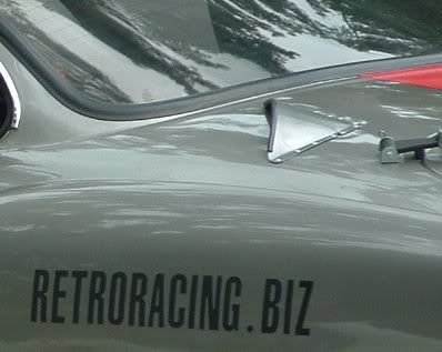

FJCamper wrote: Image
FJC,
What are the little ears to either side of the deck lid?
Thanks
BTW, I am hot for some Ghia aero!

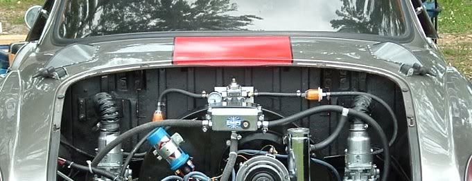

Hi ProctorSilex,
Those are small air scoops for the carburetors.
There is a flex tube under the scoops that goes to the firewall, then to the carbs. Here's a view of the engine side with tubes in place.
FJC

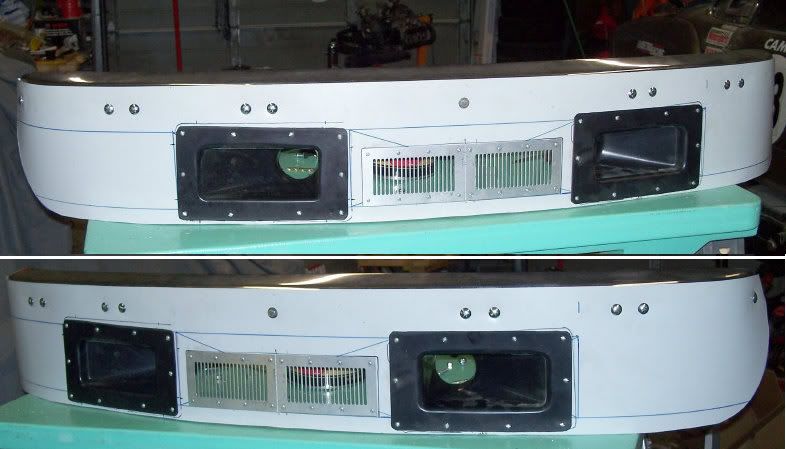

Hi Brenmobile,
These photos may give you some ideas. And, no kidding, consider front and rear fender skirts. The fronts have to be bulged a little to accommodate steering.
FJC

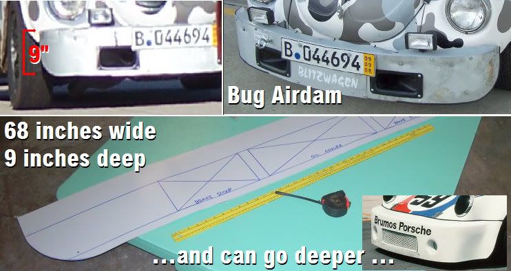

Thanks. Any ideas on how to mount a front airdam on a car with no bumpers or brackets? We filled all those holes.
Do you have any design recommendations for the rear roof spoiler?
-Bren
FJCamper
Posts: 2910
Re: beetle and aero
Post by FJCamper »
Hi Brenmobile,
With no bumper brackets, you'd have to be willing to attach a front airdam (not a spoiler -- spoilers break up or disrupt airflow, aidams dam it like water ... and I know everyone calls them spoilers) to the body with Dzus fasteners for removability, or screws or pop rivets if permanent.
The forward lower edge of a Bug is very well suited to a single piece of plastic or sheet metal, keeping it just below the hood line. The dam in this case slants with the body (slightly forward), not level, but it works, keeping air from under the car. It also adds front downforce.
