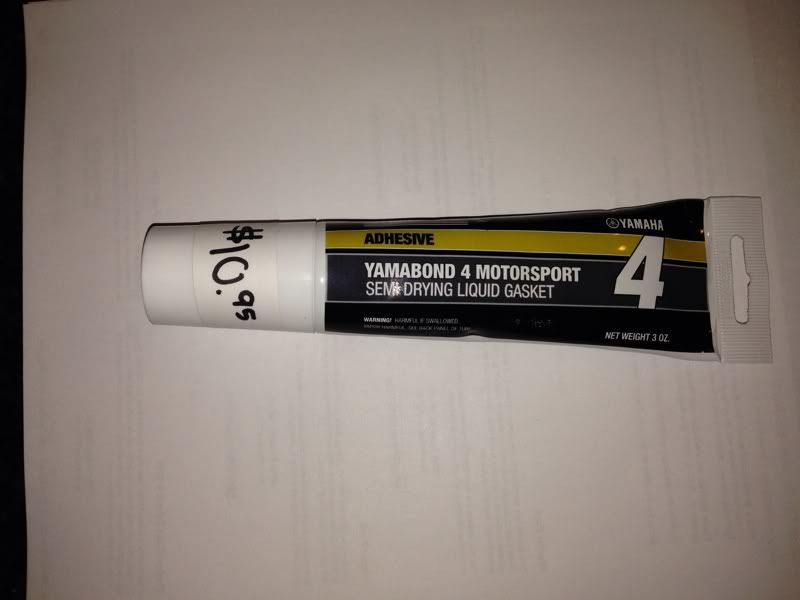

Picked up two 3 oz tubes of Yamabond 4 at the dealer $11 each. Permatex Ultra Grey is $7 for a 3.5 oz tube (for comparison).
I'm good to go for putting the trans together (sealer wise). Also sending the ring/pinion to Weddle to get REM super-finished tomorrow. I'm also going to get the center housing welded up.
I have a few days off at the end of the month and I want to get this put together. Hopefully, I won't need any shims...but I won't hold my breath.

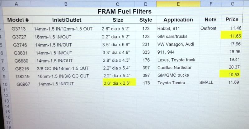

Just for fun, I looked at all the Fram fuel filters to see what might be good choices from a size, connection, and price perspective. I picked filters that are mostly threaded but not banjo fitted.
No offense to anyone, but I'm having a hard time buying a $100 billet filter for no appearant advantage? I picked the G3727 due to availability, size, and price.
Anyway here's the list, hope it help someone!

Do you have the fuel line/barbs to make that work? The filter you high lighted has M16 theads (not inlet size), the number you cite also appears to be a female thread of some sort.
- Posts: 335
- Joined: Thu Dec 03, 2009 3:04 pm
Re: '71 VW Bug truck w/Subi WRX eng/trans...Buga-Truckaru?
Both ends are female metric 16mm threaded ends. I'm going to use a metric thread to -AN fitting on both ends of the filter.sideshow wrote:Do you have the fuel line/barbs to make that work? The filter you high lighted has M16 theads (not inlet size), the number you cite also appears to be a female thread of some sort.
Like these
Did that answer your question?

If you can get that working, I'll follow your lead. You do know for certain that a GM filter will seal to an ORB/tapered/or flared fitting that the local hydraulic store stocks? GM isn't known for using "rest of the world" standards.
I do agree that fuel filters with dash fittings are crazy expensive, and the only advantage to the bling is that they come apart easy for junk inspection.
