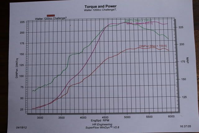

Some quick, last minute dyno testing today as someone else cancelled their appointment
Thats 20 psi for the us-readers and about 160 crank-hp from 5000-6000 rpm
Still not running right as I think their is some electrical interference still, but gained lots of valuable info today

That's impressive!
What turbo are you using Wally?
I'd be interested to see what kind of fuel consumption you see once tuned and driven "normally".
Small displacement turbo engines ftw!

133HP/liter
and there is more in it.

150hp at 4900rpm...how many displacement and how good heads do i need to have this in a N/A engine?
<3 turbo!
so let it rev and make the 200!
1 week to go walter.
<3 turbo!
