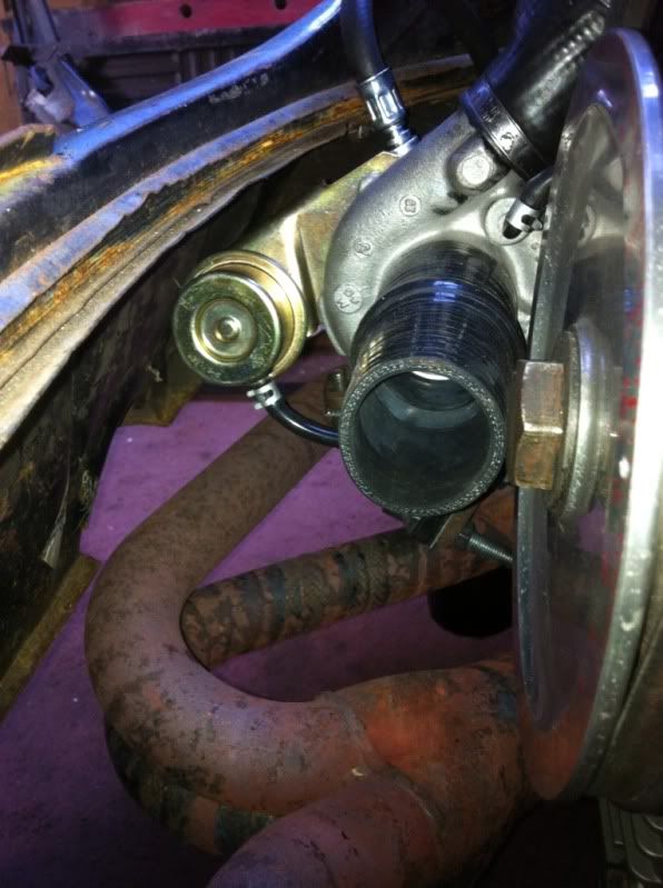

Is this your oil line into the turbo :shock:
1938vw
Posts: 525
Joined: Thu Mar 25, 2010 2:06 pm
Re: my stock 1600 dp turbo build!
Post by 1938vw »
Top of the turbo just to the left? Yes, is it the size that concerns you? No need to worry the ID is tiny, same size as the original feed from the Astra it came from.
Or was it something else?

That was it.
