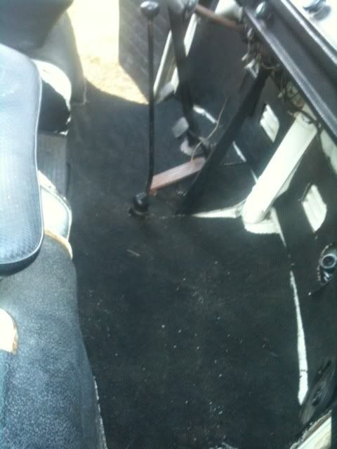

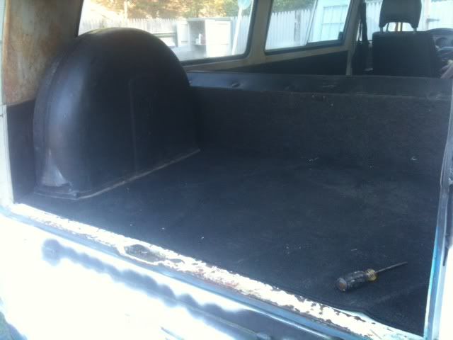

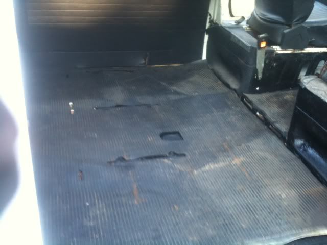

Weather too iffy today for paint so instead, today I worked on the interior after going to pick up paint and supplies.. Cleaned it good, cut and laid the carpet in the cargo area and made a mat for the front. Put the kickpanels in, carpeted them. Bedlinered the floor and cleaned up the OG center rubber mat. Hooked up the tunes (vintage 1979 Audiovox tape deck) and called it a day. If the weather holds tomorrow, I'll paint it.

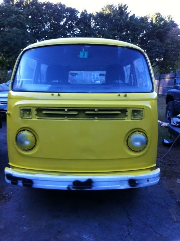

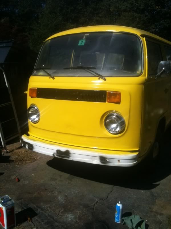

Paint:
It's going to be a daily driver and then passed on to my teenage daughter so I wasn't too anal on the bodywork, just get the rust handled. Definitely not going to appear at Pebble Beach any time soon but that's not my thing anyway:)

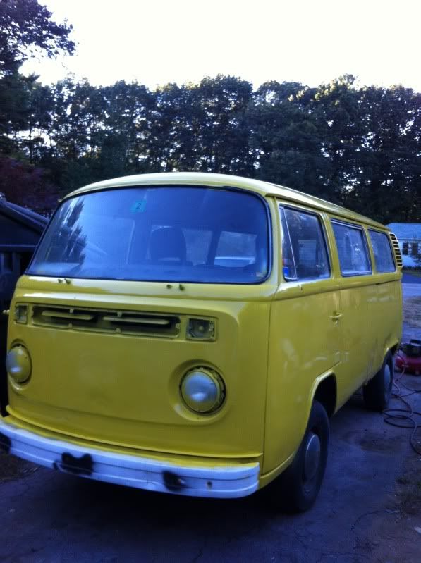

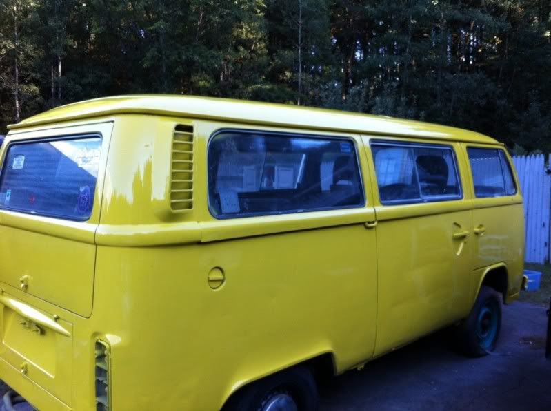

Re: I've joined the ranks

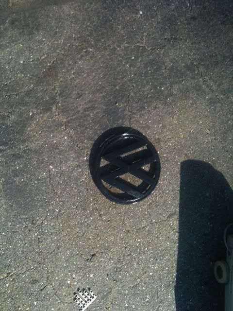

Looks much better with the little bits back on it:). Just need to repaint the bumper.
BTW, did it with implement paint from Tractor Supply (New Holland yellow). I like it better than the RustStop from Ace or Rustoleum. Goes on very nicely with either a HVLP or a old gravity feed. They sell a hardener to use with it as well. Total for a gallon plus a pint of reducer and 1/2 pint of hardener was $55. the colors are limited but they cover the basic range of them. You can see my little pancake compressor in the background of the first pic.
Very impressed with the gloss of it...not so much with my bodywork but it's a daily driver for a 19 year old so I'm sure it will see more dents and dings before she's ready to a better looking job. Disregard the masking job, I'm replacing all the bulbs so I didn't worry about masking them.
Took 1/2 gallon to do three coats.
