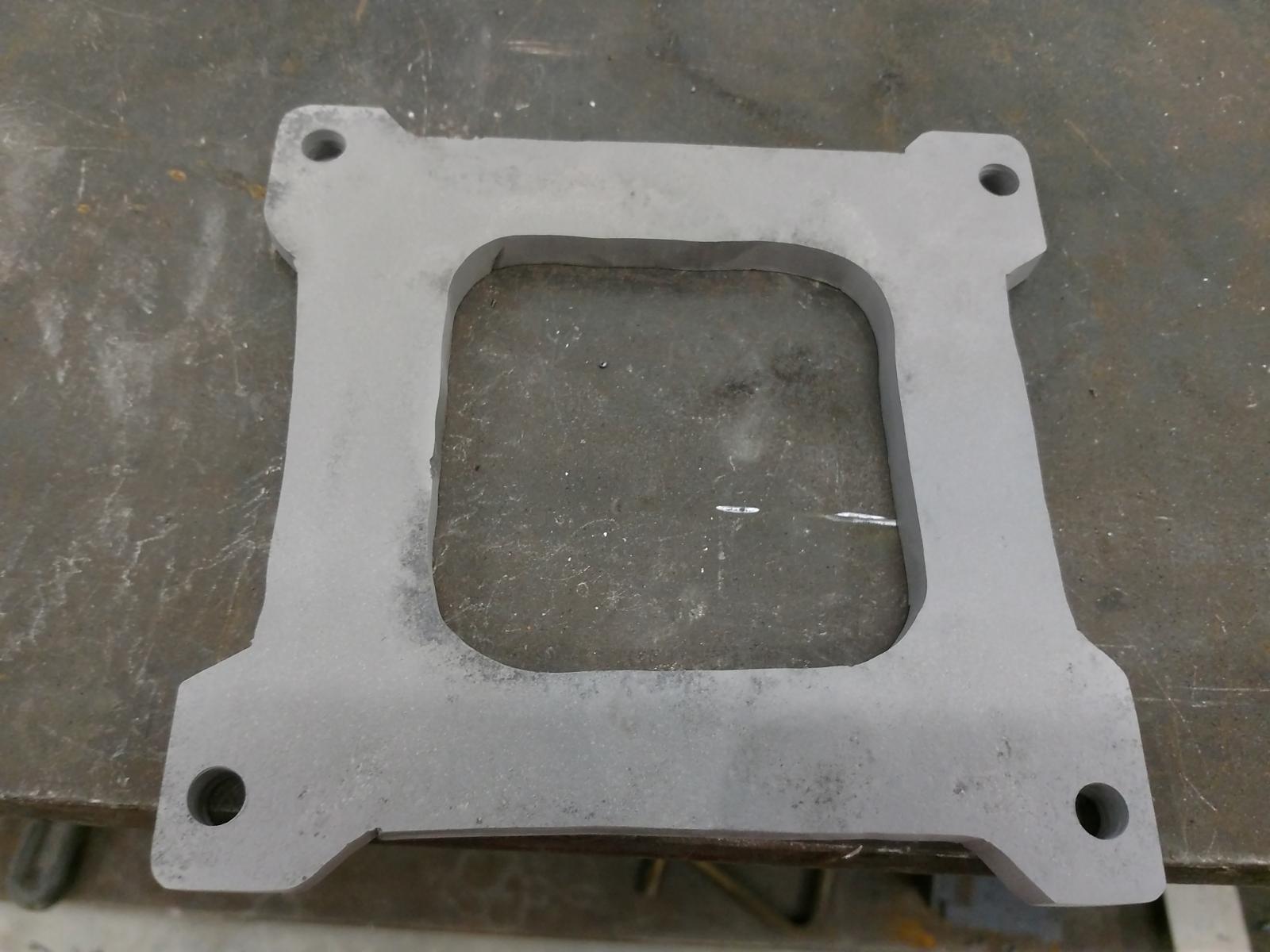

Yes it definitely is too thin of a flange. I have to use gasket maker on it to get it to seal. That's why I'm not too beat up on making a new one. When I made that one I couldn't find a flange and no where around me sold metal suitable for that. I think I'm just going to build the next one out of aluminum. I already have some 1/8" sheet, so I just need to buy a 3/8" piece to make the base flange with. Problem is once I buy all the material to build it, I'm not too far off from a pro made one. All the ones I see for sale on websites are for a 3"inlet. I think that's just too far to reduce it.

Good lord! Remind me not to ever do that again. I got some 3/8" plate and made a new carb flange. What a pain in the ass. I think I will plunk down the $25-$30 for one already made next time.

Couple more hours with the die grinder to get it close enough. But now I have a nice sturdy intake. I will have to put it to the belt sander Monday. The belt is worn out and after already being at work for 15 hours I had enough.
