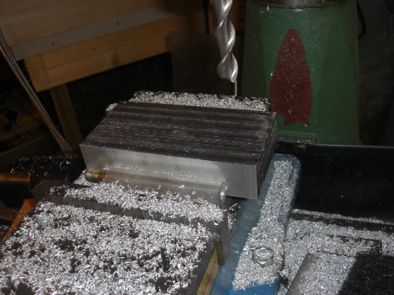

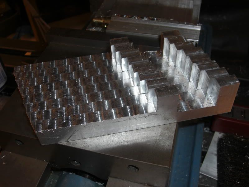

Just in case you guys think I'm slacking....A little update....I can only fit so many pieces on my small mill and before any one says use a fly cutter...I don't have one and that end mill in the pic was the sharpest one I have :lol: Also, no power feed here :D
Looks like the old mill needs a little tramming.......
take care
pete

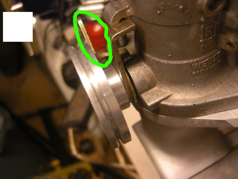

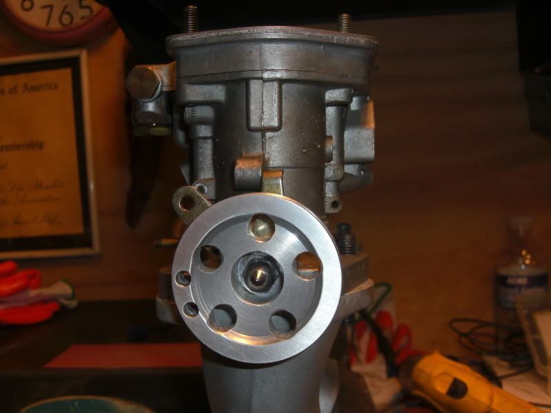

Here's the updated Weber wheel. This retains the original lever, with out modification.
In the next picture and my question to Weber owners is, What is ths part of the lever used for???
pete
Posts: 22775
Re: Project---Split cable pull linkage
Originally,it's used to pull on with a bellcrank..
I'd still try to do the split pulley//clamp thing.
You may find a screw out the backside of the pulley to mount secondary return springs is required... The Weber return springs on the shaft are a tad wimpy by themselves.
sideshow
Posts: 3428
Post by sideshow »
slowtwitch wrote:...What is this part of the lever used for???
Common use is for the cross-bar style down rod, not normally used with "under the alternator" style linkages.

Piledriver wrote: You may find a screw out the backside of the pulley to mount secondary return springs is required... The Weber return springs on the shaft are a tad wimpy by themselves.
Could the extra spring be mounted on the opposite side of the carb????
