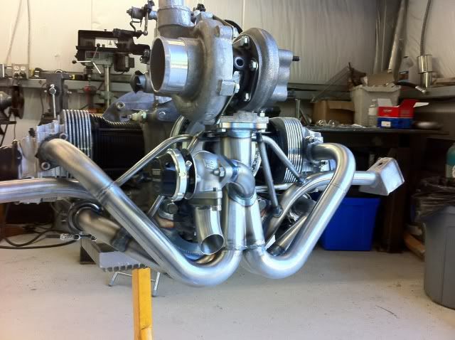

That looks AWESOME! Well done!
MarioVelotta
Posts: 4086
Re: 2276 TURBO MEGASQUIRT BUILD
Post by MarioVelotta »
Oh V-bands and everything! I love it :) Looks very nice so far. Time for me to build a new header...

Should the O2 sensor be in the collector or the exhaust from turbo outlet?
How far from turbo if in exhaust?
Thanks
"Being ready is not what matters. What matters is winning after you get there."
Posts: 4042
Post by Chip Birks »
After the turbo. The sensor's docs probably say that. Not sure how far to get it away. Read the info that came with the sensor. I didn't get mine very far from the turbo, as there simply isn't the room.

Chip Birks wrote:That looks AWESOME! Well done!
Hey Chip
I did not weld this. I found a wicked tig welder in my neighbourhood.
Those beautiful perfect smooth welds would have been impossible for me.
I want to kickass at everything, but this is my daily driver so I am desperate to get back on the road.
Dwayne Doell at Ridge Race Cars fit and welded this header for me. He was a lucky find since I was about to ship my intake and engine brace off to California.Shipping adds up.Here's his number.
