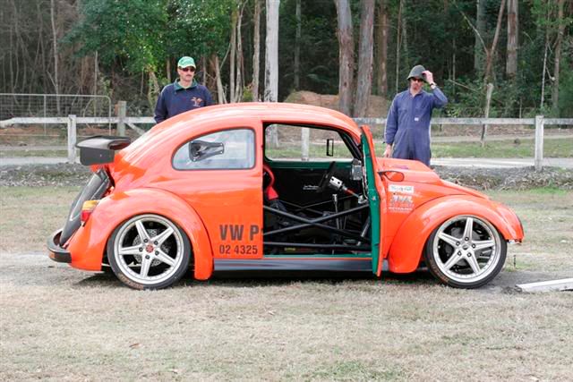

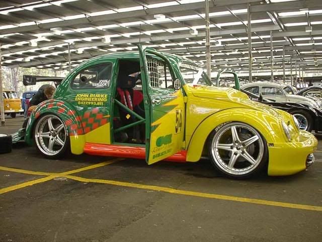

ooooorkay then.....it's a notch, that runs 10 and 11 X17 inch porsche cup wheels
thanx to 29p.s.i boost, it will spin those slicks at 90mph!!!

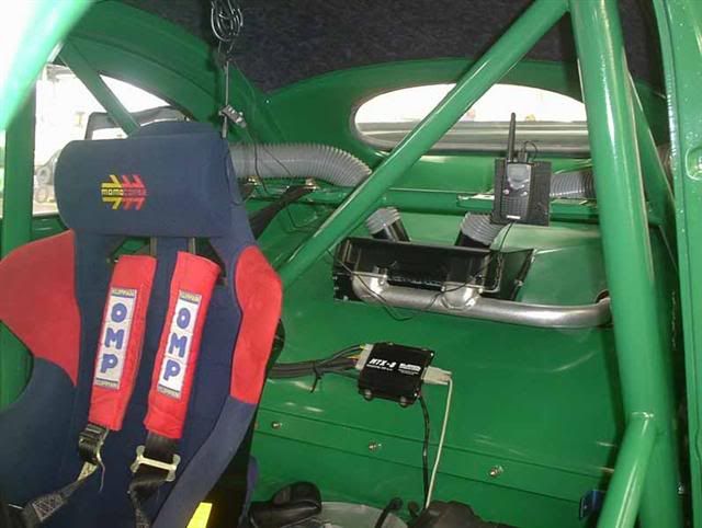

all those alloy bars hold the wrx motor in place....
and tie through with the cro mol roll cage, parcel shelf is seam welded
haltech efi system, V8 race injectors, ported inlet mannies, up graded turbo and water/air intercooler make 260kw AT THE WHEELS!......kombi 2L (5 rib) box at least is needed. berg intermediate housing, straight cut gears...55mph first gear, 80 second,118 third, 175mph fourth!!! ZF limited slip diff, 228mm four puck and kennedy stage III.......gearbox is also solid mounted to the cage.....
kombi C.V joints and superboot axles, tranny/engine mount also runs under box, and another off intermediate housing up to body...
sub frame runs up to factory type 3 engine mount points.....
other bars run horizontal to stop lateral move ments...
....and tie to body at bumper points... can see golf(rabbit?) radiator that runs via electric water pump to feed intercooler only
adjustable rear whiteline sway bar is 26mm, sway-a-way torsions are 29mm, koni gas adjustable shocks were set on chassis dyno...
rear brakes are slotted, rather large spacers :lol: ...
under the front is secondary 750gall/minute fuel pump, surge pot, and tank breather, radiator for engine cooling (thermos)...

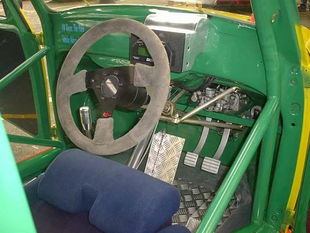

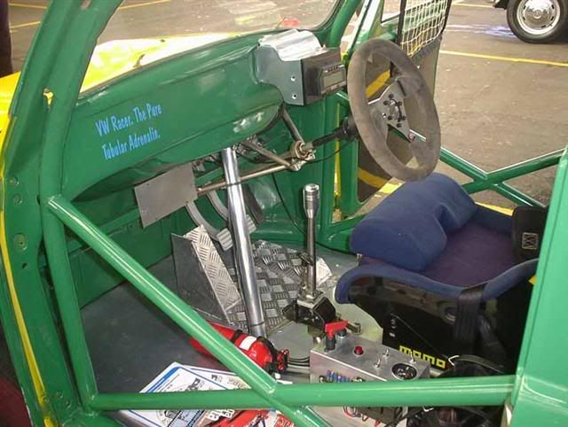

primer fuel pump under tank, coil over springs on koni gas shocks, note large "quick steer", cuts lock to lock steering down to one turn of the steering wheel!!!!
adjustable 24mm whiteline bar and type 3 wagon (squareback?) slotted discs and calipers....
bare minimum in cockpit........8500rpm redline!!

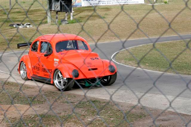

sorry about all the dirt and mud underneath, last outing, the weekend started nice ....
but got very wet!......
........and a little slippery!!!!!!

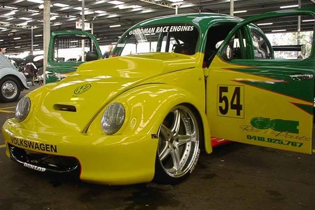

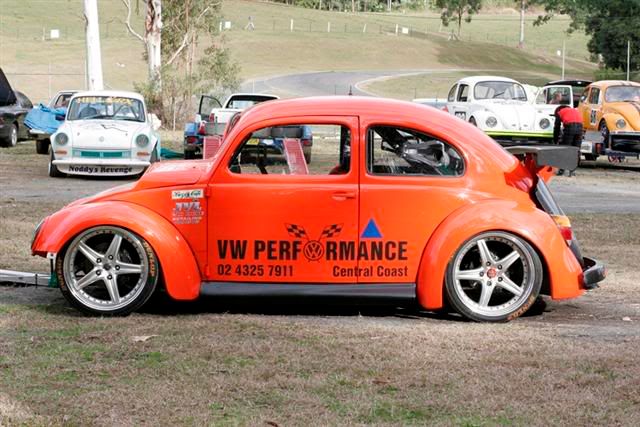

a mates '54.....
it's been a long build with a couple of colours..........

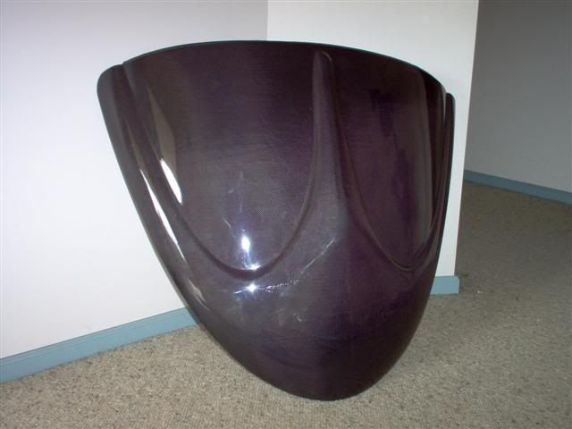

my C'fiber decked daily......

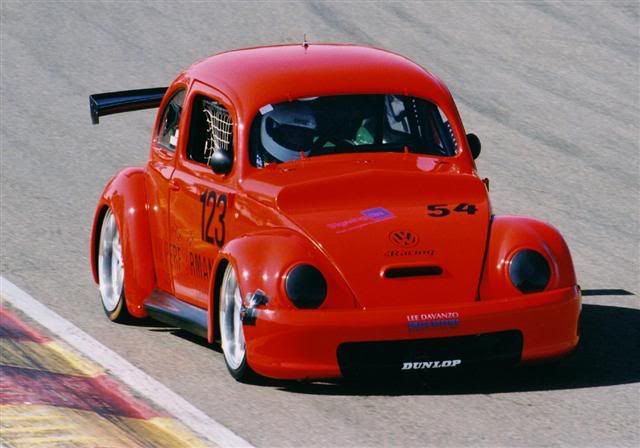

Hello boys,yeah thats my Dub Racer Orange one,its had a color change and lots of new goodies. Thanks Damo posting those pics. :wink:
