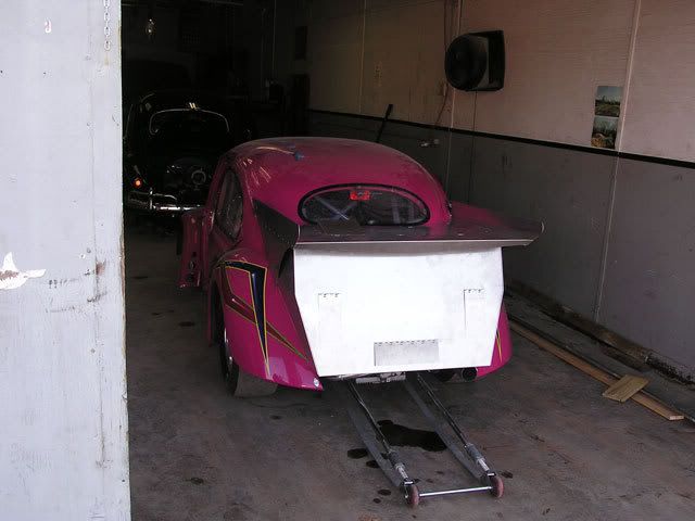

You better get that thing together... We have some racing to do... You better get used to this LOL

Get used to what :?: ........your bug parked w/ a big oil spot under your motor? :lol:
I'm gonna get a rear view mirror for my dragster so I can see what you look like going down the track! :lol:
