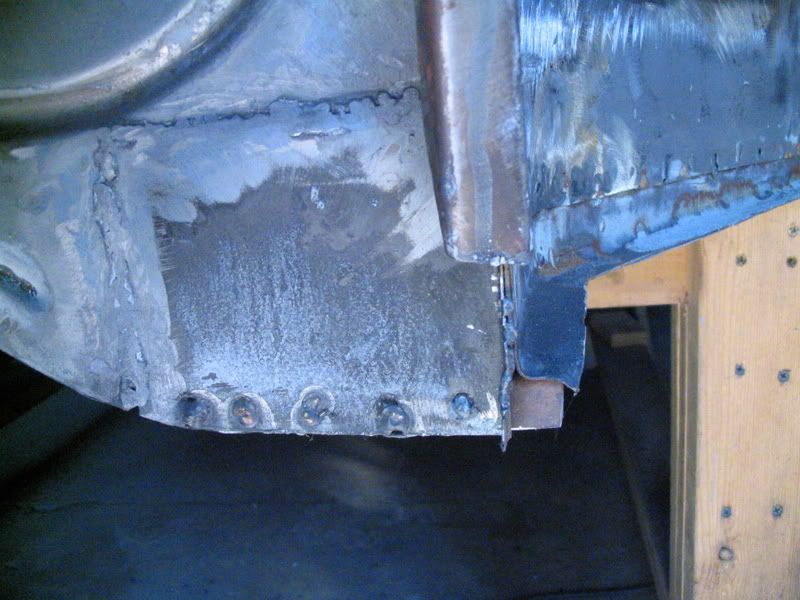

I'm not sure what to do about the front. I had to grind off a continuous weld in the corner before I could get the old chanel out. Now I've got a big hole to fill in.

crvc wrote:http://i77.photobucket.com/albums/j47/k ... 2849-1.jpg

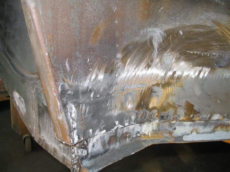

Kevin, I had to repair the front of mine also. I just used a piece of left over metal, bent it to the og shape. I'll post a pic of it later tonight.
Also, after I tacked in my channel, I installed the door and double checked the fit (before i completely welded in the channel). I did have to break a tack on the "B" post and give it a nudge for a good looking fit.

That's a good idea. I planned to put the body onto the frame to check whether the holes will match up with the heater channel nuts but I'll attach the door as well. Since I'm replacing the luggage shelf I've got lots of metal from the old shelf that I can use to patch holes like the one up front.

here are a couple of pics of the front repair....
Almost done with this part :D
