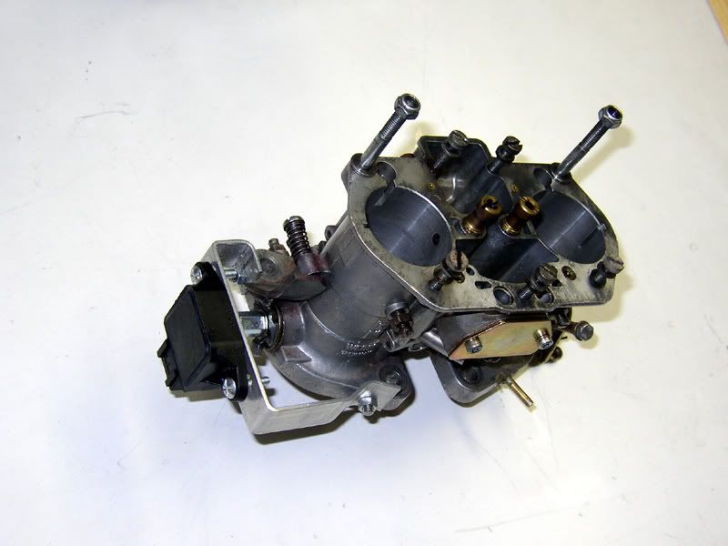

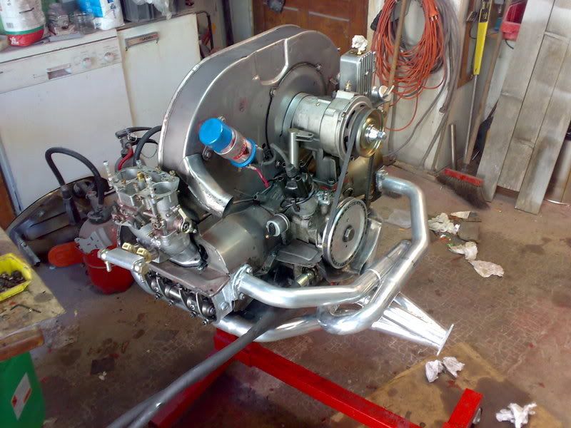

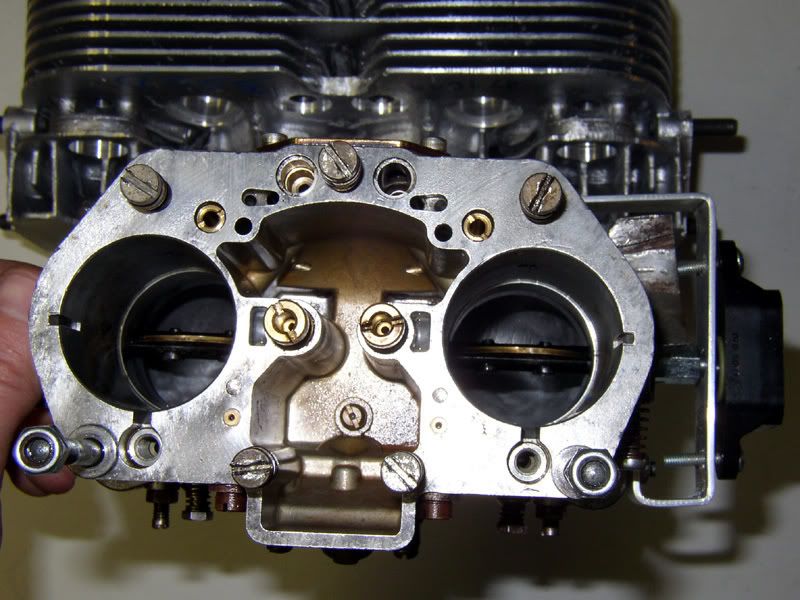

Some news with that project...
I used the IDF's on my 2 liter and it works wonder!
No air leaks, etc. I had to clog them in some places but now it looks just like a twin carb setup, and works like a megasquirted' engine, so if some of you ever thought about it, money wise or not, it's worth it and it works very well!
I modified the intakes, and that's it!
cheers
Leo
Some pics of the mods we did:
and the lady hehe
cheers
Leo
and the lady hehe

I just modify my Webers 40 for TB's buy closing off the main jet (full the hole in the jet with JB weld) also block the choke passages on the bottom of the carb, if your carb is equipped with chokes., Added a Ford TPS. Thats all you have to do
