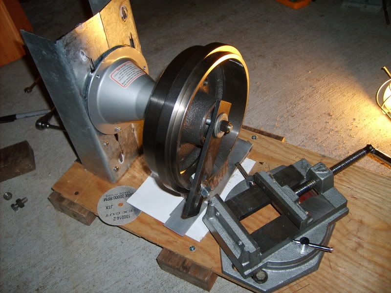

OK, I got a jig setup to slot drums. I've been running slotted rotors up front on my Golf for 10 years and there is quite a difference. The slots allow hot gases trapped against the surface to escape keeping the brakes cooler. If the surface gets coated with water too(big puddle, etc.) this helps swipe it clean quicker. Slots tend to not chew up the pads or shoes quite as much as cross-drilling.
Pictured here the jig setup with rear drums for my Golf(any drum will work though). You may be asking why even use a jig? Go ahead and try this freehand, you could really make a mess of the brake surface trying to hold the cutter steady. Also note, setting up the slots 120 degrees apart is easy, I simply rotate the base mechanism up against the 'L' brackets over to the next setting(no guesswork).

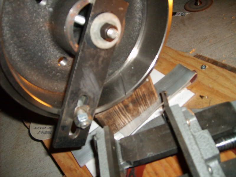

One of the slots visible here, this is a passenger side drum for reference.

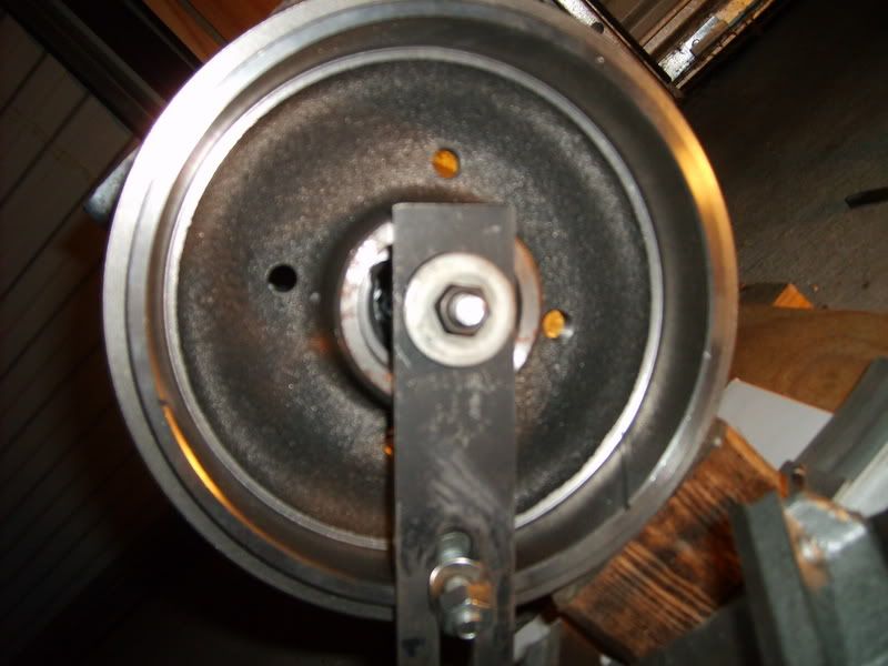

The slots offset 120 degrees apart(60 degrees is also possible).
