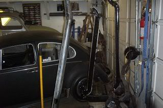

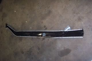

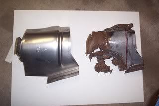

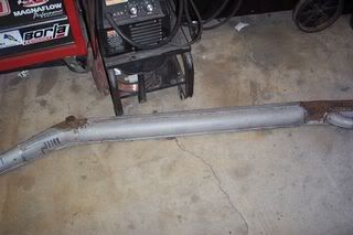

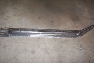

here are some pics:
channel before:
After:
after inside:
Fabbed panel for cross member:
Everything hanging to dry. The heat tube was split and por-15 inside and out and welded back together:

I am still looking for the side by side pics of the original and aftyermarket channels.
