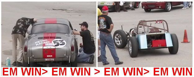

Classes
Gentlemen,
About SCCA and Solo2...
When we were just a 1.6, but looked racy, SCCA made us run FSP (F Street Prepared). Very competitive class. We started late in the season and missed the yearly champtionship by two points.
When we briefly went to a 2 liter, we were bumped up to DM, D-Modified. Wow, more competition. We took the yearly championship anyway. And the rules people did a switch and gave that year's DM championship to a local sponsor, compensating us with the EM championship.
When we went to 2.2 liters, it was EM. Katy bar the door! Here came the Vipers, V6 and Wankle Lotus kitcars, etc. We took the championship anyway. The points were so close on the last event we ran that the championship was literally going to whomever won, us or a V6 Lotus-7. We won.
FJC
