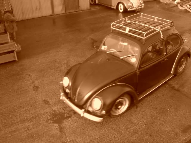

here it is before i started with the conversion

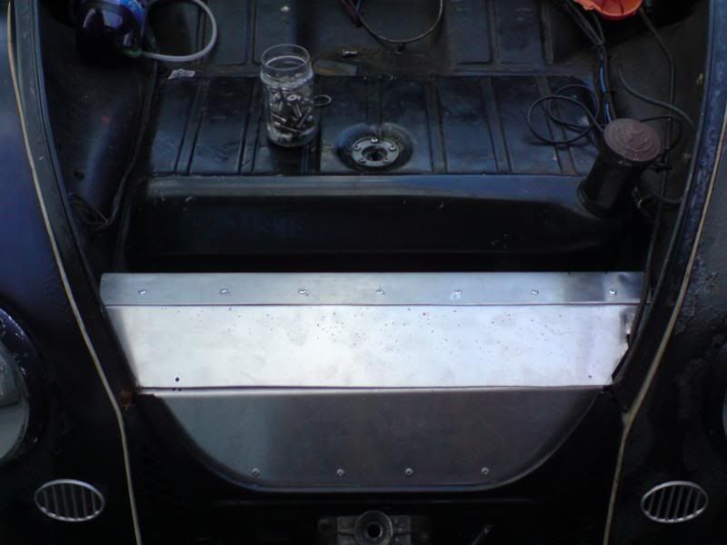

not much to do with the engine but while i wait for funds i have been cortin out the engine bay and boot for new elecs etc
this photo is a bit pants but i painted it in metallic gun metal grey and added some glitter in so it looks like a insane metalflake job
bare metaled the boot also and painted it new, at the moment it's my favorite part of the car, I'm debating whether to splash out on powder coating the petrol tank as it needs painting, i want something durable and it would look great.
took some pics, the black is actually satin but i took the pic while it was wet, it looks much better now.

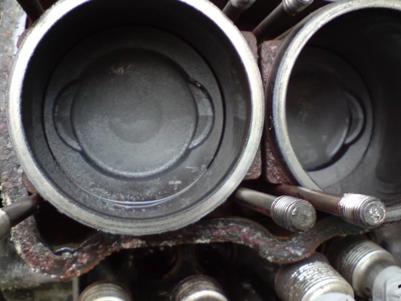

i'm not an expert but my pistons look like what i thought were low comp pistons, can anyone tell by this pic?
WBX Man
Posts: 97
Joined: Sun Jan 16, 2005 10:21 am
Post by WBX Man »
Stephanhipwell wrote:i'm not an expert but my pistons look like what i thought were low comp pistons, can anyone tell by this pic?
No, if this is a 2.1 engine you got the DJ pistons (high CR, 10.5:1)

cool, i just found a pic of one with the low CR and the concave bit is much bigger. thanks.
