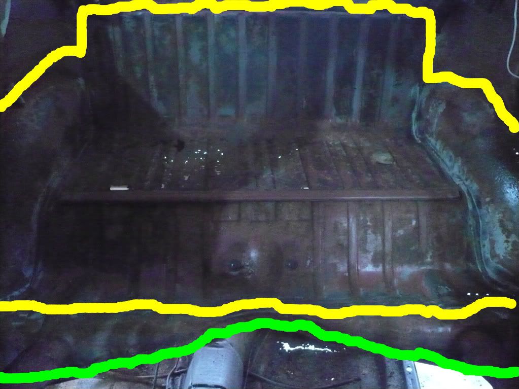

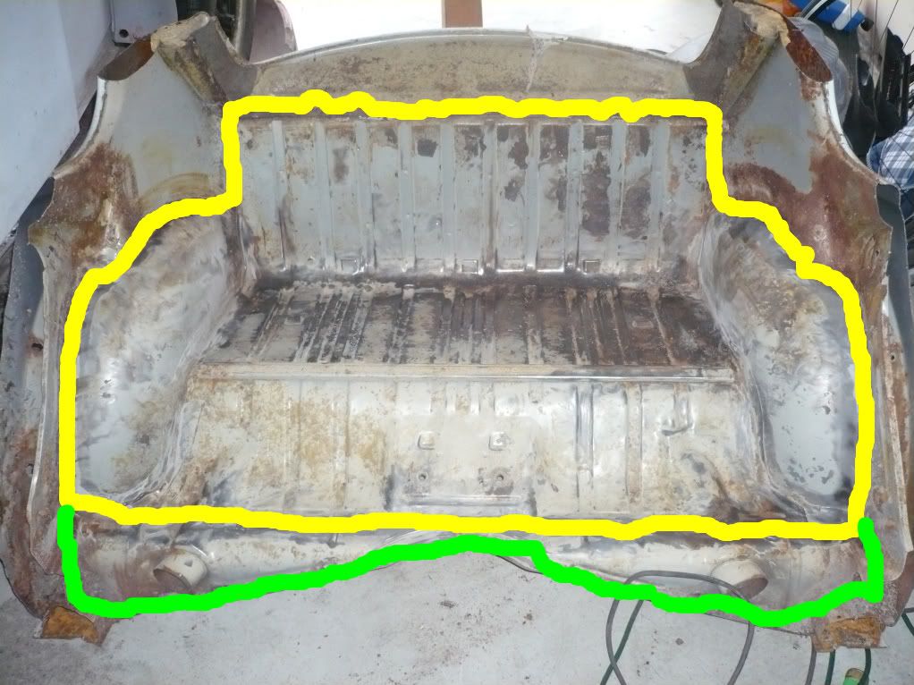

I would like to replace the parts in yellow and green on my 67 type 1 but would do just the yellow if it is better my idea is to try to do it all at once if possible
Here is the parts I was able to get from Avery's Air-Cooled in Woodland Washington. Again I have highlighted the areas in Yellow and Green. Any recommendations on how to get this done.
Thanks

With the body off it would be easy to section. Try to plan your cuts so both sides of the welds can be primed. The more places you can splice at where the panels are spot welded the less panel warpage.

perrib wrote:With the body off it would be easy to section. Try to plan your cuts so both sides of the welds can be primed. The more places you can splice at where the panels are spot welded the less panel warpage.
Body is off. So do I just drill out spot welds on both and remove or do I just cut out then deal with spot welds? Finally can I go all the way down to the green areas?

If you remove the majority of the luggage panel you will have much better access to the spot welds.
Poke around with a pick to see how bad the panel under the luggage panel (highlighted in green) that is bolted to the body is. If it is bad change it. Blair spot weld cutters are the best. Snap On Tools also sells Blair if your body shop supply company does not.
The replacement section should be welded with the body attached to the pan.

perrib wrote:If you remove the majority of the luggage panel you will have much better access to the spot welds.
Thanks again for the tips are you talking about an air-tool(Blair)? So you know I am a novice this is my first project. I have a Mig Welder, 4.5" grinder and basic tools that's about it.
Lastly I wanted to clarify I can remove the bad shelf with the body off the pan but need to put the body back on before I weld the shelf etc in.

yes.. fit the new replacement panel on your body.
"Blair" are the brand of "spot weld cutters" (specialty drill bits for removing spot welds)

Hopefully the videos speak for themselves if not here is my updated plan. Cut out Shelf plus pieces on wheel wells then weld together pieces if you have any suggestions/feedback it would be appreciated.
