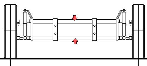

FJC "remove the locknut and setscrew from the center mount one of your two front torsion bar tubes, top or botton, it doesn't matter, to soften up the front end. "
Went to do it but I am not sure what the center mount is. Are these the ones on the arm? If so -do you take the both sides off on say, the lower arm, or just on one side ?
- FJCamper
- Posts: 2910
- Joined: Wed Nov 14, 2007 2:19 pm
Which is which
Hi D7,
Remove the locknut and setscrew (center location see arrow) from either the top or bottom torsion tube, to soften up your ride.
You can put it back if you need to.
FJC
