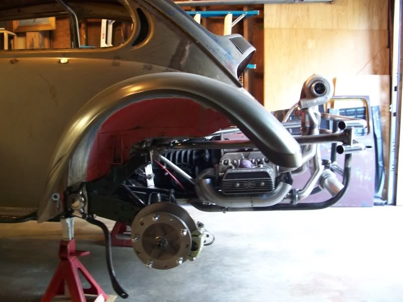

I wish I had a better pic with the mount or something (it's all in pieces right now) , but this is the kit made by AC Industries ( I think), baught it from So Cal. These are 1" wider (choose stock or 1" wider) and come with 12mx1.5 threads, or use the .560" holes and some 1/2" fine thread press-in studs 8) . I think they're Rabbit calipers? Not sure. Came with park brake cables and tubes and bolted right up to stock T-1 IRS arms. Kinda heavy, ductile iron rotor, but seems strong. I had to fab the mounts because I caged the arms and messed up all the clearance for the caliper mounting area. No big deal.
Let me know if you want some more detailed pics of the mounts/trailing arms.
