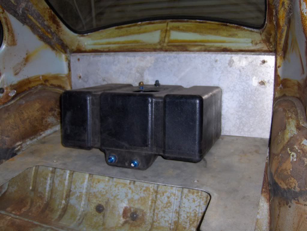

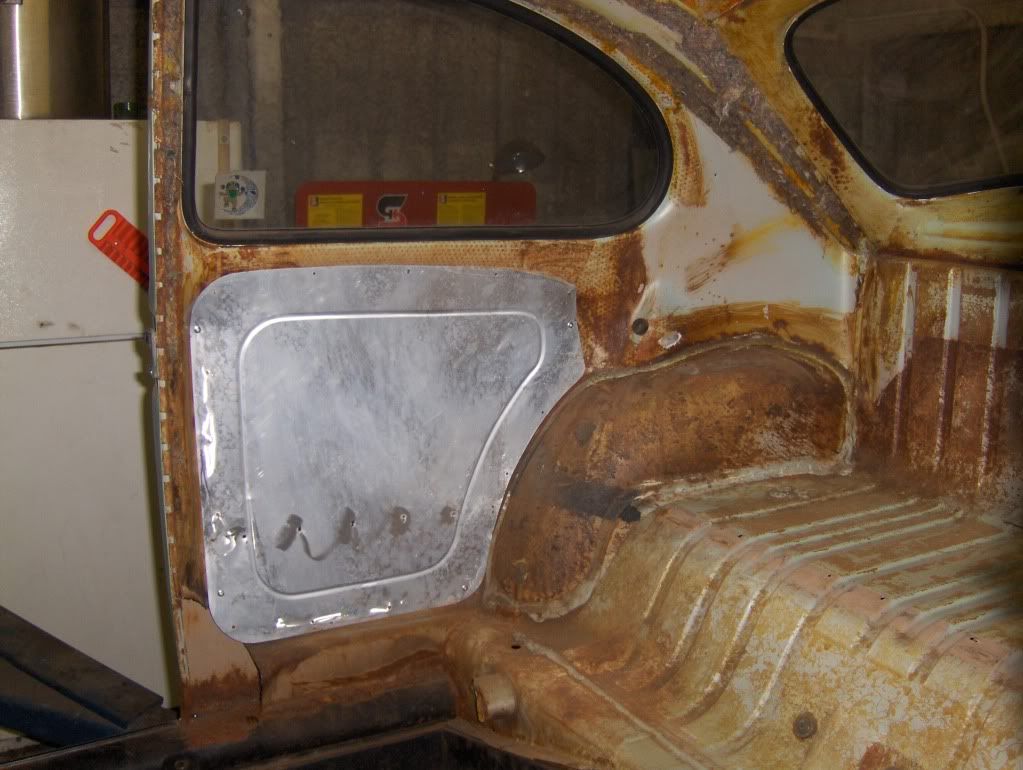

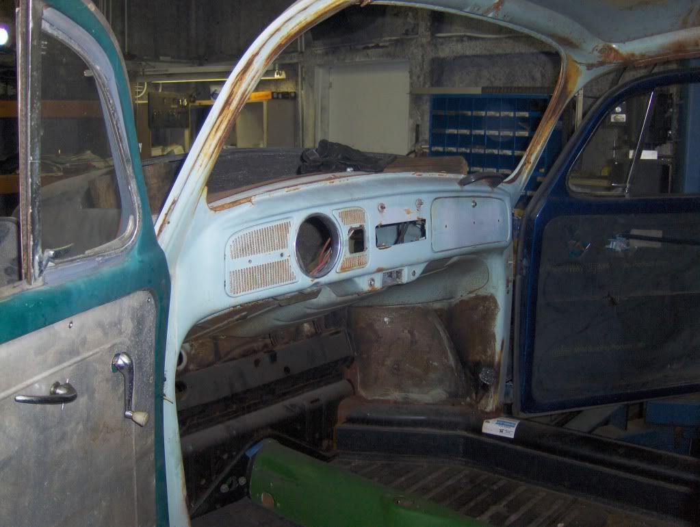

Here are a couple of interior shots of my Baja. I have noticed a lot of you guys leave it like this. I see roll cage installed and these areas of the car to put it bluntly look like crap. After the cage is installed it is harder to sand these areas. So for however long it me I will be removing the surface rust, priming and painting the inside of the car. I bought a few different things like sponge type sanding blocks, sand paper 320 grit if I remember correctly. It takes quite a bit of elbow grease to get a paint-able surface. So it is understandable why these areas don't get the attention they need. I meant to hit the pawn store today, but didn't make it, so I could pick up a electric sander to use on the flat areas to speed things up.
In the pic below most of what looks like rust is glue is there anything that will remove the glue without costing a arm and a leg?

You have a lot of work in front of you. Instead of a electric sander the Scotch Brite style stripping pads that attached to a die grinder will speed up your task as will a small paint gun style sandblaster for the deep pits. I thjink a sponge with muratic acid would work but might get a little bit to interesting without a rain coat and eye protection. A heat gun and scraper also work for removing glue and seam sealer.

Spray on rust converter is your friend too. I made quick work of my pans and wheels with it. I sanded off the heavy surface stuff and converted the rest. I really enjoyed the fumes too.

I would just prep and paint the dash and doors. For everything else its just easier to cover with cheapo carpet from the flaps. The carpet does help with noise levels and it keeps stuff from sliding around. Gives things a nice finished look without all the work.

I won't be using any carpet in my car, so I will be cleaning it up and painting it. It already has new floor pans and heater channels. The floor pans have been sprayed with Line-X. Putting carpet in a off road car isn't something I would do. If the carpet gets wet it takes for ever to dry. Without carpet you can use a wet vac and suck out the water if need be. I think it is best to clean up the rust and use some preventive maintenance rather than cover it up.

What I found is working best to clean up the interior is a side grinder with a twisted wire wheel on it.
