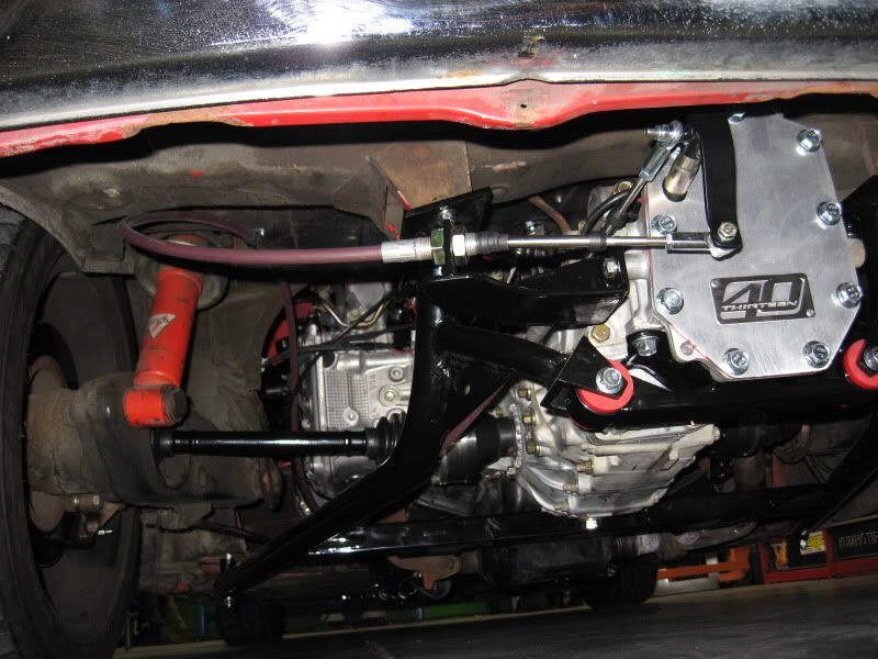

Cable shifter at the transmission. Beautiful work.

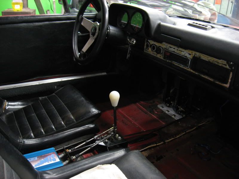

And inside the car, the modified MR2 shifter. Feels notchy, accurate, and good, which is what this is all about. That and more strength, especially in first where the Porsche 901/914 transmission can't stand much torque.
A video of the shifter, still in the prototype stage, showing the action in the front and the rear:

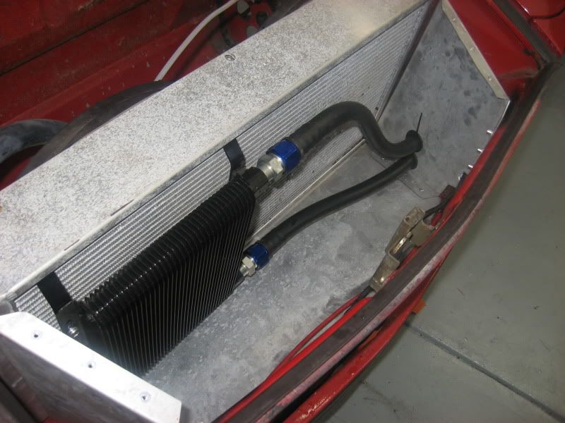

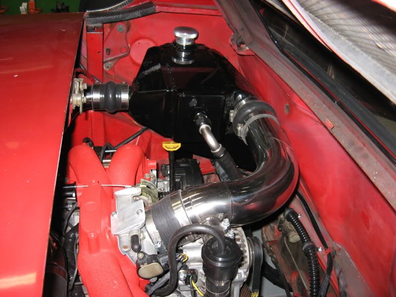

The water-air intercooler. It will go just ahead of the engine on the driver's side.
In the car you can see part of the new cradle, just tacked for the moment.
Axles are aligned.
Business end, seen from the rear. It looks so good we'll probably go without a valence, this stuff has gotta be seen. I can't wait until in the rearview mirror I see another 914 guy who's pulled up behind and is trying to figure out what all happened back there.
It was a monster before, but you had to be real gentlemanly with the shifter. To hell with that. I can't wait. The other part of the project is the water-air intercooler. This is where we started, with the WRX engine conversion already done (which was also 55superbeetle's work):

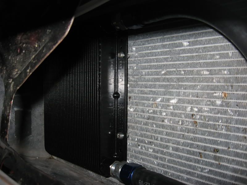

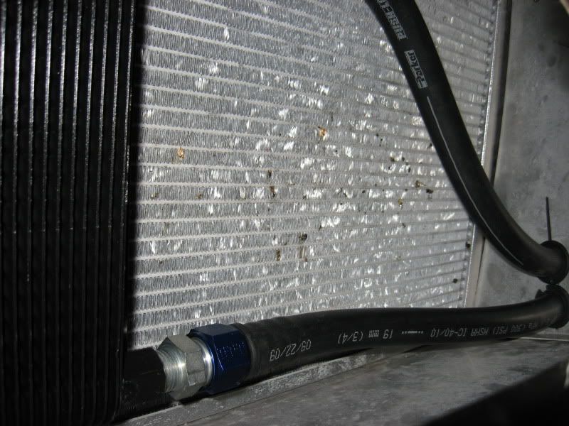

The intercooler didn't have enough airflow there. One thought was to put a scoop on the bottom of the firewall, forcing air up, and if we found out we needed to we could compliment that with a ducktail spoiler at the back of the roof to create some low pressure over the engine lid, plus fans, of course. But wait a minute, take a step back and think how silly that is, to do all that just so you can put your radiator in that particular location, where it will still probably only work half-assed anyway. So Jeff's solution was to just put the intercooler radiator in the front in its more natural location. Done and dusted. Better aesthetically and more functional as well, so win-win.

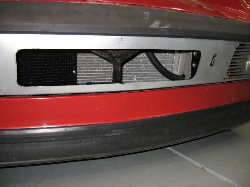

This is where it will be, cute little thing, hidden in front of the engine radiator in the front of the car. An engine radiator where we originally had the air-air intercooler would be even more problematic.
The new intercooler layout:
Seen from car level:

And the intercooler powder coated:

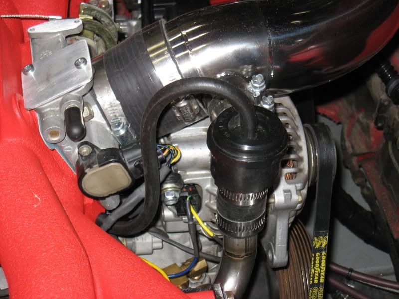

It will look good with all the stainless steel inlet tubing. The manifold was re-painted after the bosses were removed:
How the flipped manifold will look on the engine, pretty clean:
The inlet pipe so we’ll recirculate instead of dumping it out:

And the water connections to the little intercooler radiator in the front of the car:

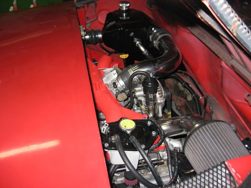

Engine bay seen from the other side, with the de-bossed and now re-painted manifold. We'll leave the stock overflow tank on the aircleaner side of the manifold, so those bosses are still there.:
This next shot shows the shine on the powdercoated intercooler and polished tubing, but also gives you an idea of the clearance from the engine to the rear firewall:

The shift cables under the car, plenty of room and as long as they aren’t lying on top of the axles the routing isn’t critical:
And how the muffler fits under the rear, with the new exhaust exit:

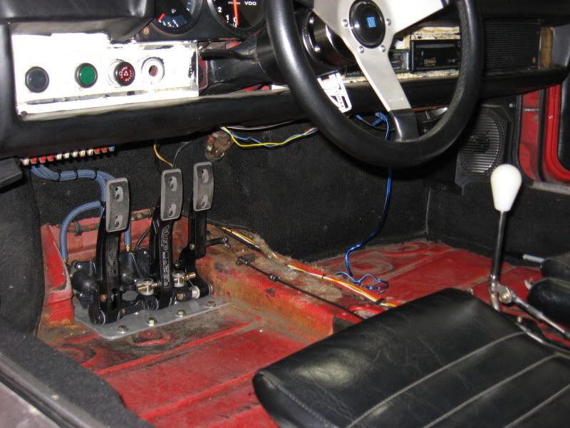

It’s all looking really good. 55Superbeetle was going to have to make some major changes to the stock pedal cluster to fit in a clutch master cylinder, so we decided just to go with a Tilton pedal set. Very sexy, proven function, no lack of options or spare parts, and lots easier in the long run.
