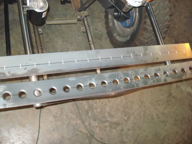

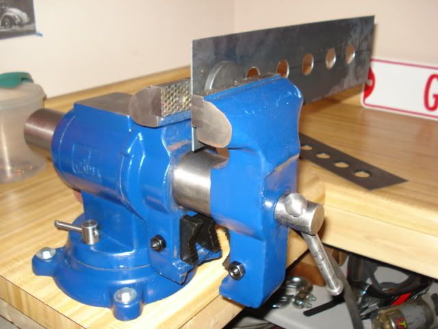

CWB... Here is how I did mine. I've seen them on ebay for like 250 ish for a set of 5. I think they offer a couple of different sets like 3/4-2" and 1 1/2 to 3" or something like that.

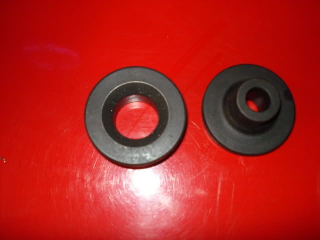

This is the die ...
Practice...

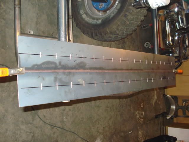

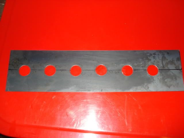

First step... measure and drill holes

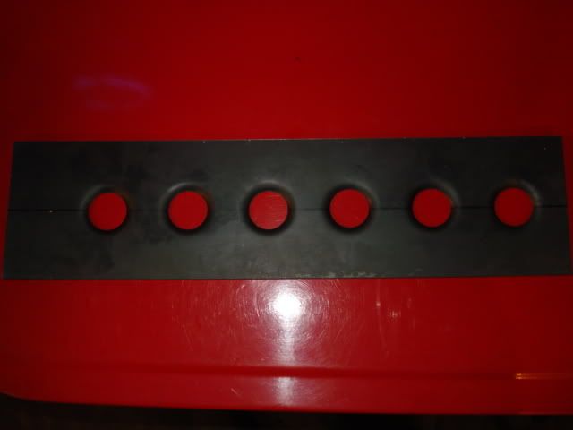

Insert into the "squeezinator" and squeeze...

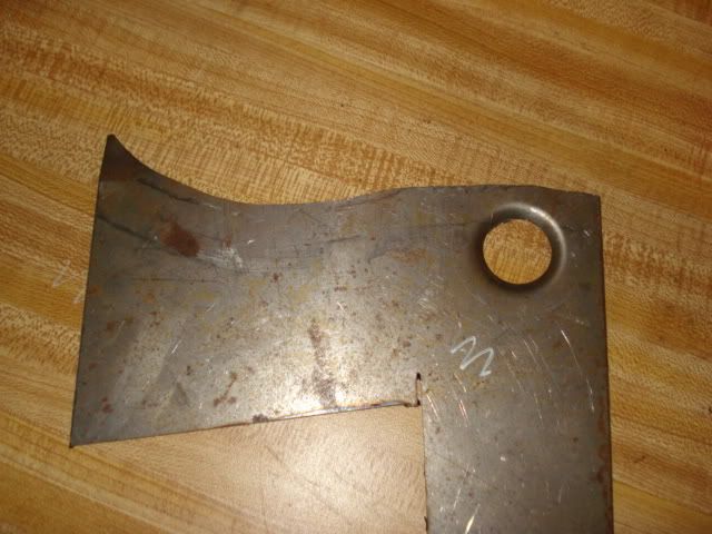

1st piece done... these will be for the "A" pillar

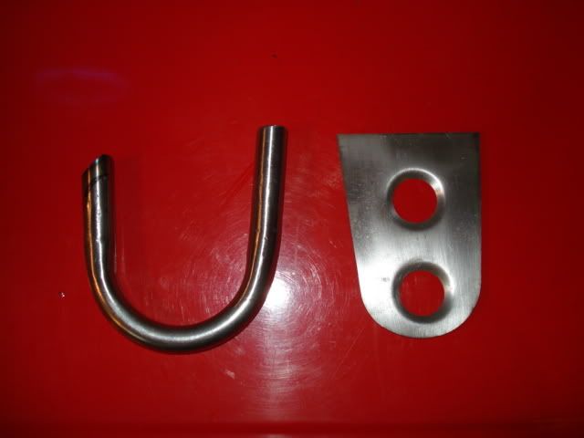

Sill plates being measured up...
One down... one to go...

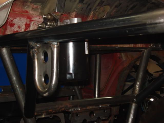

Made this little thing to protect the oil filter...
Installed...
All of these parts will be added whem I mount the body for the last time. I just wanted to have them ready. I will post more pics at that time

This is the die ...

Those look more like flanged holes than dimples; the main difference is flanged holes usually have a 90 * flange rather than being something like a CSK (countersink) as dimples usually do. Interesting! Do you remember where you got them?
