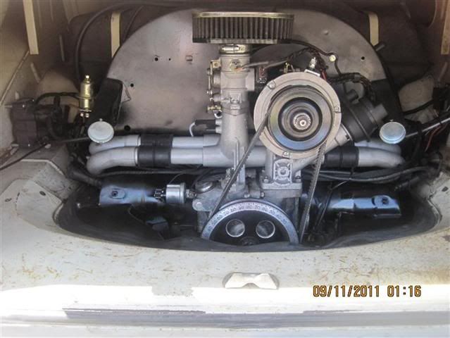

It is a 2276 with a To4E I got from Shag (again a super stand up guy I would recommend to anyone). Its got a 6 rib too :twisted: with folts axle conversion. Here is how it was:

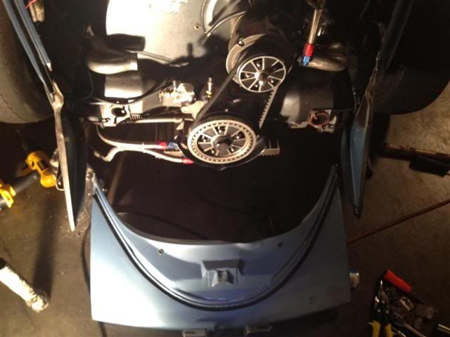

Made the apron removable for easy maintanance and engine removal in the future. Wish i would have done this a long time ago. Its so nice!
Relocated the wastegate to the collector on a cb hideaway header
Started mocking up parts

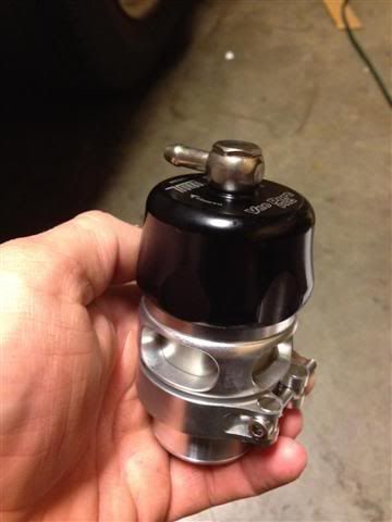

Turbosmart Vee Port Pro from Marty (thanks for the fast shipping!)

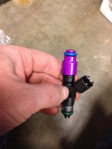

Zander wrote: I'm in the process of getting them swapped out or getting just the purple adapter hats to be 60mm.
The purple hats may not be the best option for you, mine have the filter located there, and a huge gaping hole at the top of the actual injector. You may need to stick with the swapping out plan. Good choice on injector though. Pricey, but should definitely be worth your while. Awesome looking build you've got going, good luck!

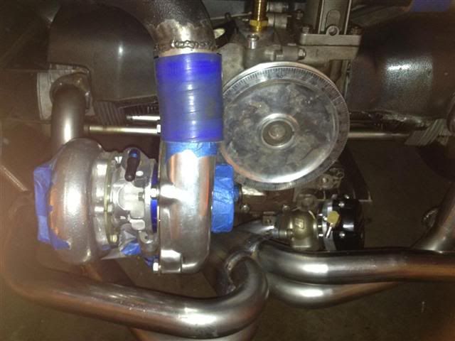

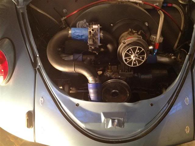

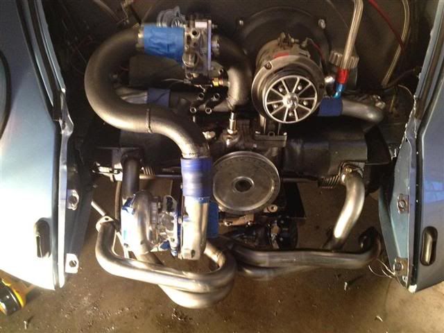

Got some silicone couplers and test fitted.

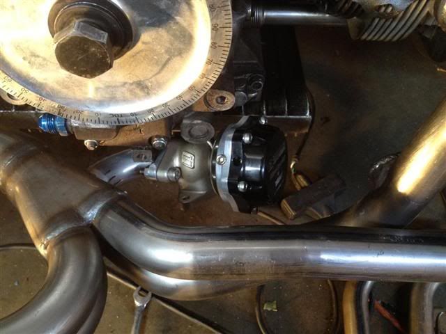

Welded on a pipe to locate BOV.

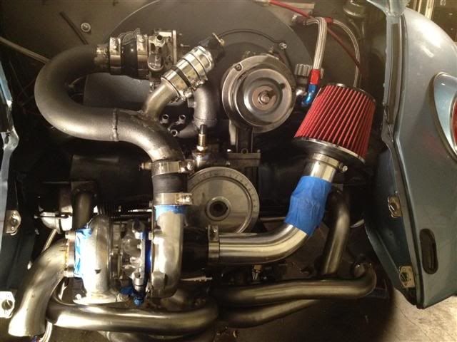

Mocked up intake (need one more coupler)
Made an exhaust dump. Going to work on a muffler setup as well.
Also received my adapter hats to make the ID1000's work.

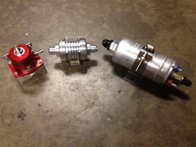

Oh, and also received a few parts to get busy plumbing in:
The 044 is quite a bit bigger than the walbro on my bus and the Golan filter is a pretty impressive looking piece.
