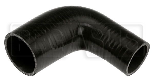

I'm going to make a simple T manifold or use a progressive intake manifold with an adapter plate to connect everything. Do you think the 60mm will be to big, if so what about if I use a reducing hose off the TB to the air filter to make things a bit smaller.
Maybe a reducer like this connected to an air filter box?

The 40mm is much better sized to your engine.
With the 60mm, the first half of throttle will be overly sensitive and the second half won't have any effect because the engine will already be effectively at "wide open throttle" well before the actual throttle is fully open. Adding a reducer in front of the throttle isn't going to change that. The throttle acts just like a variable diameter pipe, and flow through a pipe into the engine is essentially limited by the smallest diameter. If the airbox opening was 40mm, the throttle will work normally until it opens to around an effective 40mm in diameter. If it opens farther, the airflow is effectively capped by the airbox opening instead of the throttle so opening the throttle more has little effect on the engine. Same effect happens when the engine has less airflow capacity than the throttle body.
