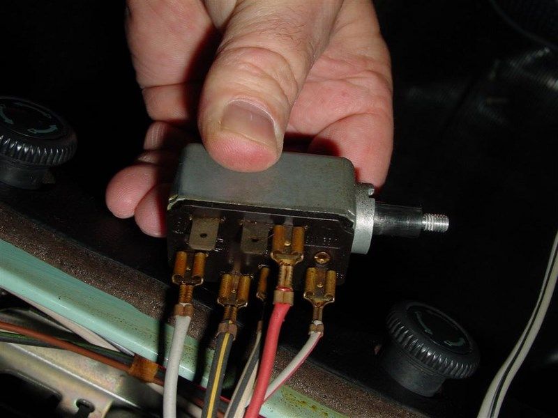

`71-up switch:
`71-up switch with wires attached - note the single, lighter-gauge red term 30 wire (all it handles is the park/taillamp current):

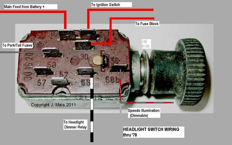

`68-`70 switch (311 905 865A) - note the triple term 30's, power from the back went to the light switch first on these:
...the term 57's are for the front parking lamps in early-style headlight assemblies; later-production switches may have them omitted. They're "hot" at the first click but switch off when the knob's pulled fully out.

Ok, that gives me something to go on. Looks like somehow the switch pictured has the black/yellow going direct to the X terminal on the switch. Is that one located differently? Anyhow, the heavy red wire coming off of my ignition switch is going to the 30 terminal on the headlight switch. This is a big help though, thanks for your patience! I will investigate and post what I find. Thanks Marc, you rock!

Ok, sorry the pic is a bit blurry. It's late but I had to go out and just have a quick look. Someone has been up to something. This switch does have the X terminal. The non factory style connector is currently hooked to it. Also strange is the tiny little terminal, 58b I think, with an improper connector. I'm still not sure what's going on but is it safe to hook my black/yellow to the X terminal and give it a shot? Also, will this possibly fix my issue?

I don't recall when they went to the narrower lug for term 58b (dash illum lights). Ideally you'd change the female connector to match, but if the wide one fits snugly it'll function OK.
Sometimes the "X" wire from the inline junction between the ignition switch and the headlamp switch is black/yellow, sometimes its red/black (fortunately the latter is rare, since its easy to confuse with the starter solenoid term 50 wire).
Looks like they rigged it to provide on-all-the-time power to the X terminal. If you lose that non-stock wire and feed "X" with the black/yellow wire from the ignition switch it'll make it so the key must be on for the headlights to work...but it won't help the "clocking" problem you're having at the ignition switch contacts.
