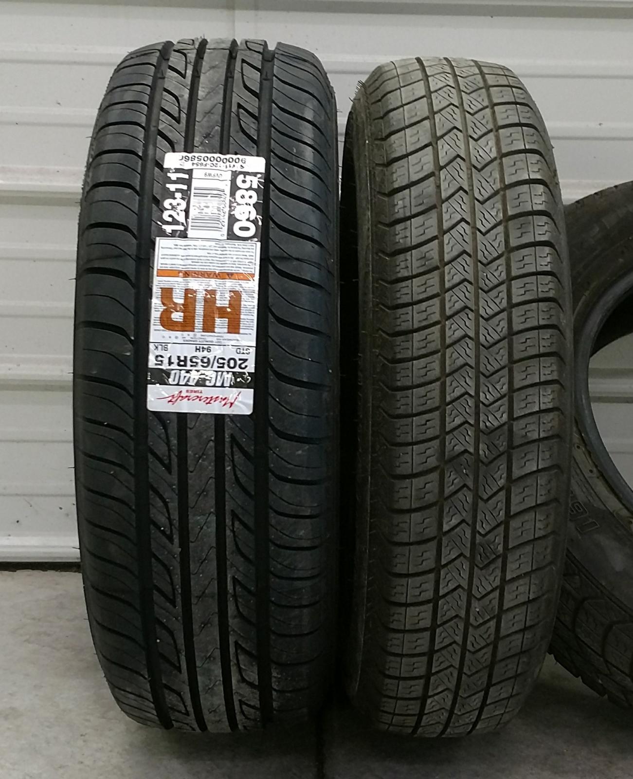

Got the new tires mounted. I was kind of hoping they were just a bit taller to load up the engine a bit more. Oh well. Here is the 205/65/15 next to the old 165/15.

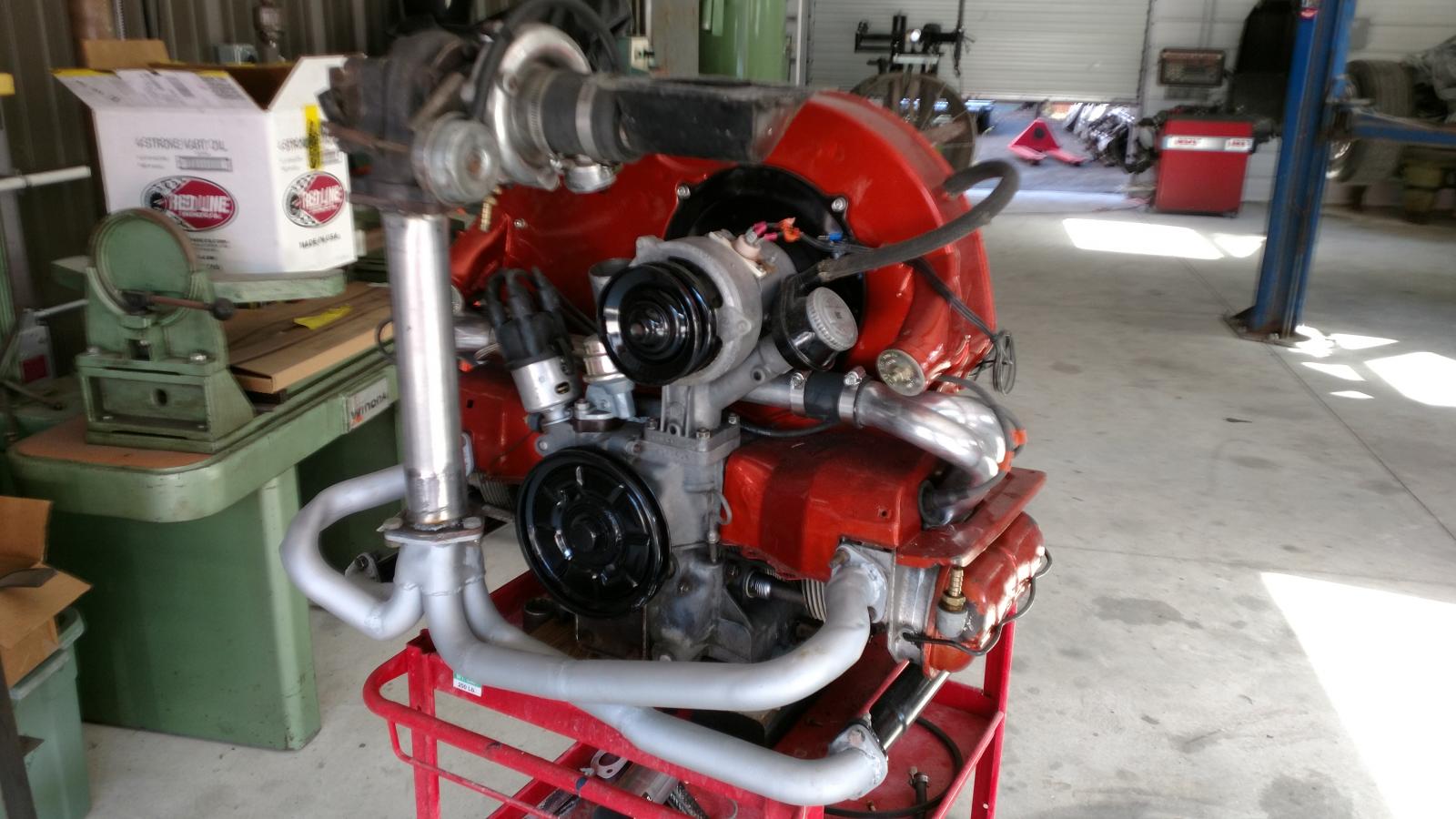

Hey guys is like to try to get my engine back in and buttoned up this weekend but I need some opinions. I have a junkyard made header where the collector ends near the engine tin. The header is 1 3/8" and it turned out I made the up-pipe out of 1 3/8" too. So I want to make my new up pipe before I put the engine back in. It looks like 2 1/4" or 2 1/2" would fit the flanges best. What do you think would be the best size? My engine is stock1600 besides single HD springs and chromoly pushrods. T3 42/48 with a Holley 450 4 bbl.

Do you think I should go even smaller? I was afraid I was choking it with the 4 into 1 1 3/8" up pipe.

I use a 2" up pipe and my turbine inlet is 1 7/8ths.
You could go 2" and then taper to 1 3/8ths at the inlet if that is the diameter.
Use about a 3 inch long taper to neck it down.

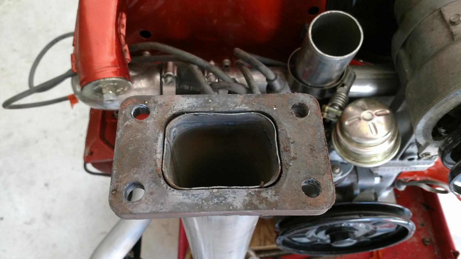

The opening on mine is a rectangle. Looks like 2"x2 1/4"

That didn't work at all. I wanted to move the turbo out and up a little (I like how a draw through looks hanging out there).I guess I went too far out and up so it looks super dumb. Guess I will be cutting the flange off in the morning and doing something different. I want to get the engine back in tomorrow so I will have to get creative since I don't have access to any bends at the moment.

Oh yeah. I ended up using 2 1/4" pipe it fit the best in the rectangle and it was very close to my lower flange size too.
