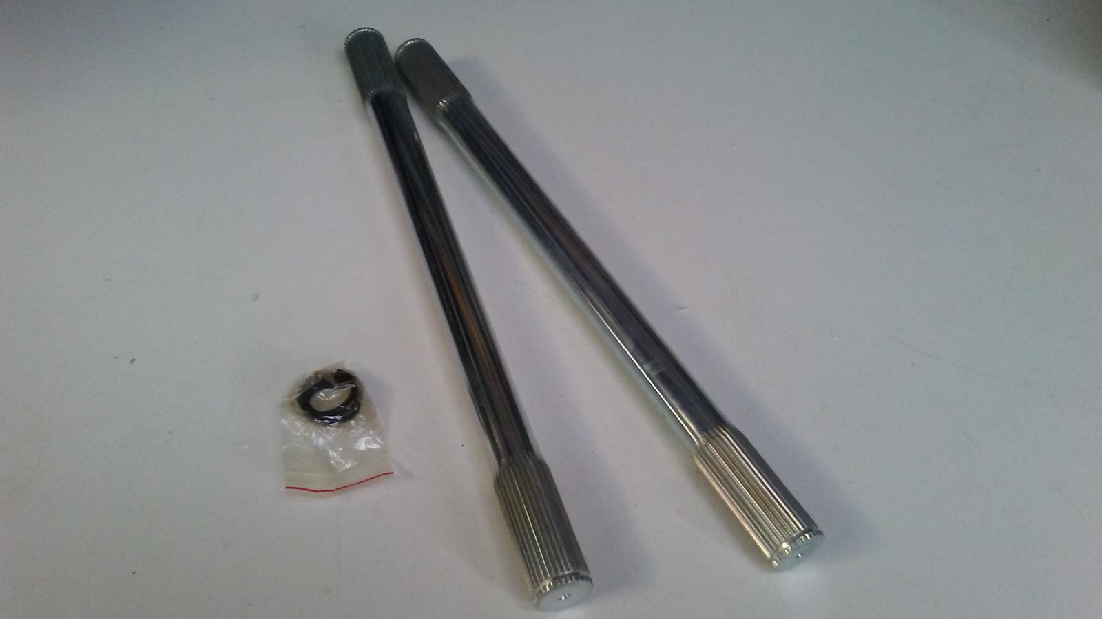

I had some custom length axles for my T1 SSC into my '66 bus from an offroad place, don't remember which one but both were equal length of course. Aren't the T3 autos axles unequal length IIRC?

Did you ever look into automatic 944 axles?
IIRC, they are different lengths on the autos.
Interesting how aftermarket axles come with no inner shoulder to seat against the CV.
The snap ring at the outer, or captivity, to hold them in..?
SOP seems to be to just let them float?
https://www.thesamba.com/vw/gallery/pix/1650261.jpg
I'm too lazy to re-size right now...
Speedier than a Fasting Bullet!
Beginners' how-to Type 4 build thread ---> http://shoptalkforums.com/viewtopic.php?f=1&t=145853
Posts: 22776
Re: Installation of an automatic _into_ a T3.. factory did it, easy, right?
On the 944 auto axles, I'll research their length, but I used what was handy, so it was probably a win.
Yes, the off road folk let the long spline aftermarket axles float, which tends to punch holes in the drive cup seals.
I made mine a tight fit, I'm not using the ~18" of theoretically possible travel anyway, although it probably has 10, most of which is never used..
