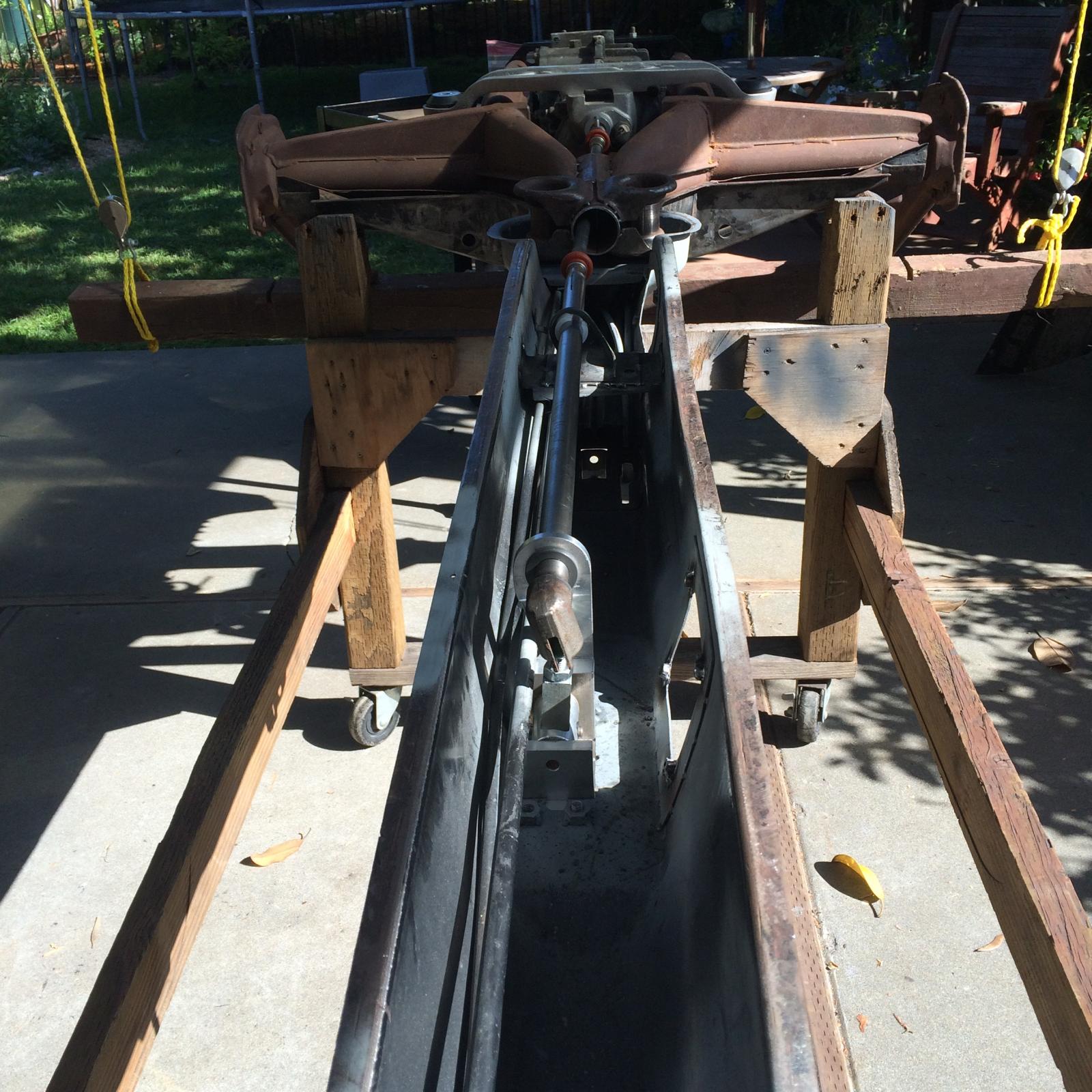

Here's a Cable Shifter in a 914.Piledriver wrote: ↑Tue Sep 14, 2021 10:03 pm ... If there was room I'd consider adapting a modern cable shifter...

^^Wonder how that actually shifts^^R2.0 wrote: ↑Wed Sep 15, 2021 8:23 amHere's a Cable Shifter in a 914.Piledriver wrote: ↑Tue Sep 14, 2021 10:03 pm ... If there was room I'd consider adapting a modern cable shifter...
While it's certainly a cool bit of engineering/fab,
I'd be -real- interested in trying it out, if y'know what i mean..

I know its been done on a 914, and may go there if I use a std 914/901.R2.0 wrote: ↑Wed Sep 15, 2021 8:23 amHere's a Cable Shifter in a 914.Piledriver wrote: ↑Tue Sep 14, 2021 10:03 pm ... If there was room I'd consider adapting a modern cable shifter...
... but the discussion is about a T3...With a 723 trans swap. Bit different animal.
The mechanics seem doable though, one cable push/pull, one to rotate.
Possibly better action than the off axis monkey motion shift rod setup seen on most 901/915 trans installs.
I do use such a setup on a regular basis, exept it's in a mk4 tdi...

I submitted it as more proof of concept. I bookmarked that page for reference when I started thinking about putting a 901 in my Ghia. Now I've decided on a Bug@5speed setup.Piledriver wrote: ↑Wed Sep 15, 2021 2:14 pm
When I can find a 914 tail shifter cheap.
