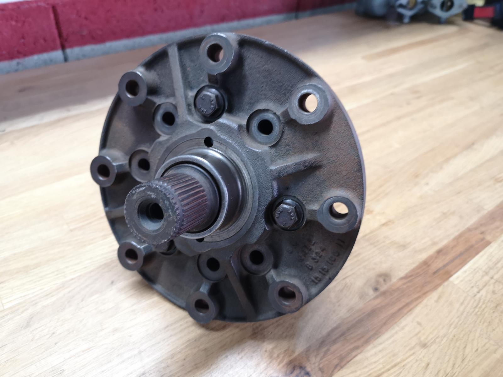

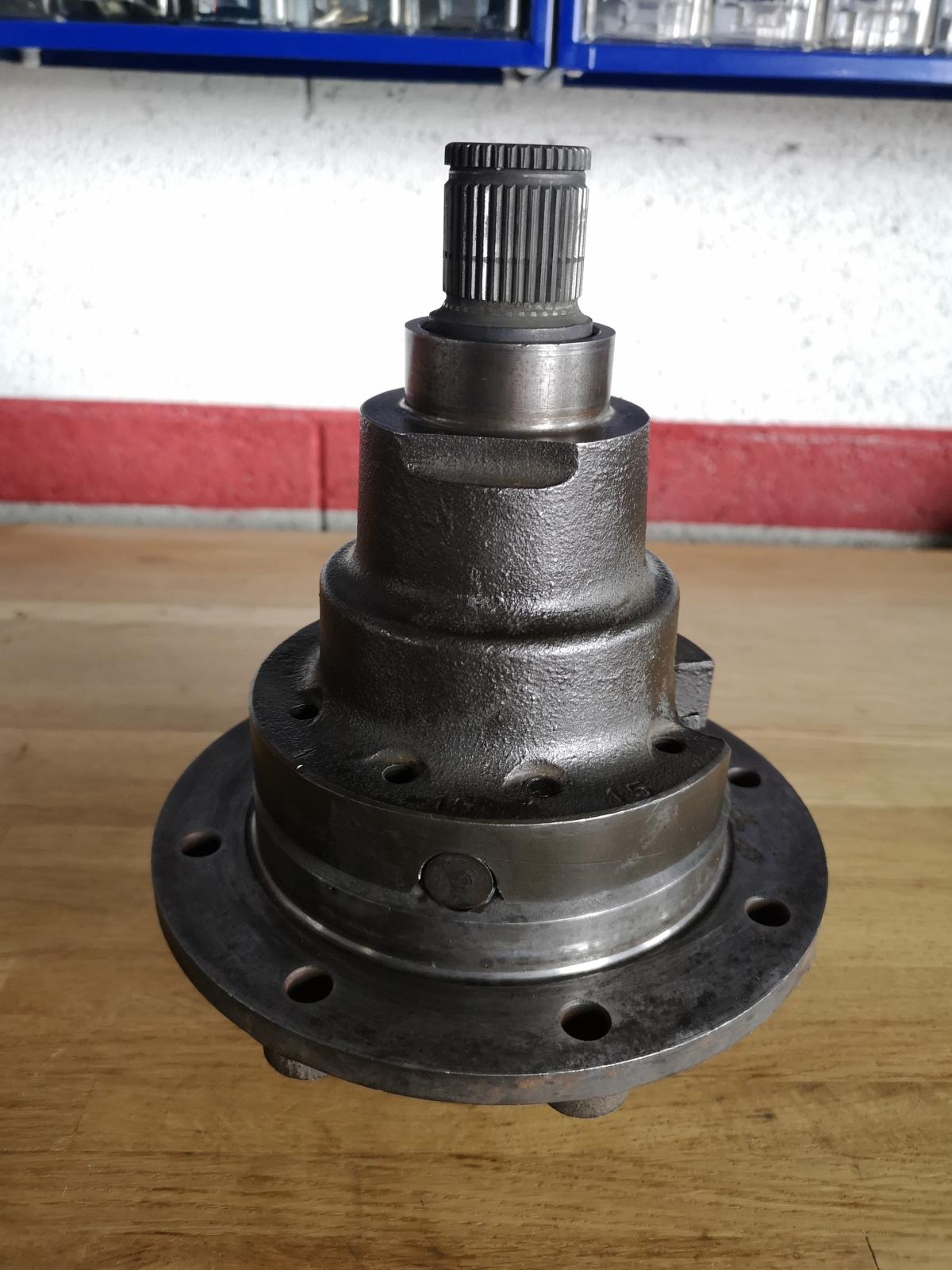

From outside
here you can see the springs to preload the cone style clutch
springs actually push against the sidegears

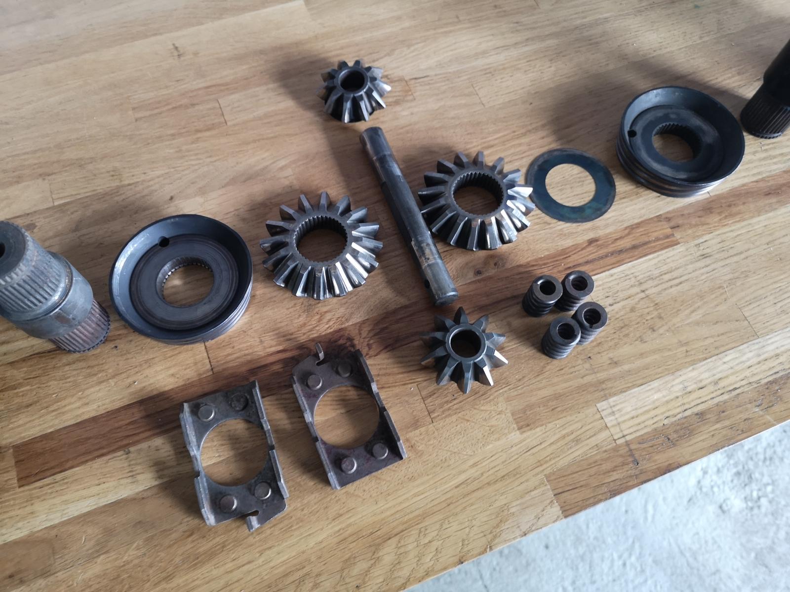

and here is the cone. When torque is applied to the diff, the cones below the side gears are pushed harder against the carrier, acting as a clutch to lock the sidegear to the carrier. There are oil galeries to keep them lubricated.
Everything disassembled
Sidegears next to the cones
Another view of the clutch
Output flanges are difficult to rotate separately because of the spring preload on the cones. Holding the diff by hand, I can't move them. The diff gives a good impression, I wonder how it behaves on the street ;-)
