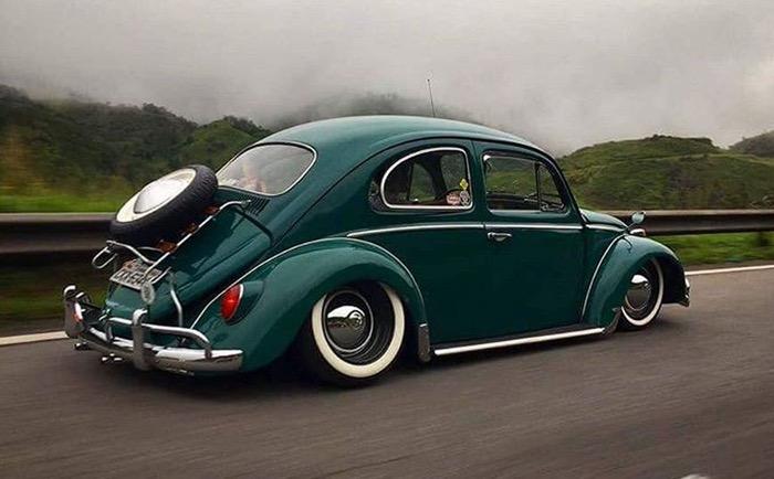

No, not being a smart ass at all. Engine/trans raise is the only way to lower a swing axle car, and keep the axles somewhat level. There are also trailing arms, and CV joints that allow you to lower your VW quite a bit, and still have somewhat of a tread contact patch. There are still those that insist on lowering swing axle cars with stock suspensions to the point of needing to remove the bump stop mount.
If I can’t talk them out of it, I’d like to give them a little more bearing life.
I’m talking about cars like this....
