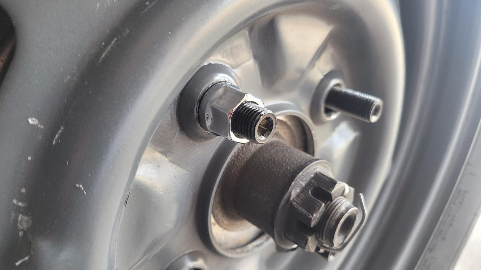

I know there are kits available to convert the stock wheel bolts to studs but I wanted to do it myself. How hard can it be...? I ordered a set of 14mm X 1.5 studs from Amazon with a set of matching nuts. Looked good, "seemed" to fit etc... until I go to remove a front wheel and noticed one of the nuts bottomed out on the stud shoulder. This is when I realized I was using the wrong nuts.
Here is the nuts I originally ordered. They are a 60* taper style.

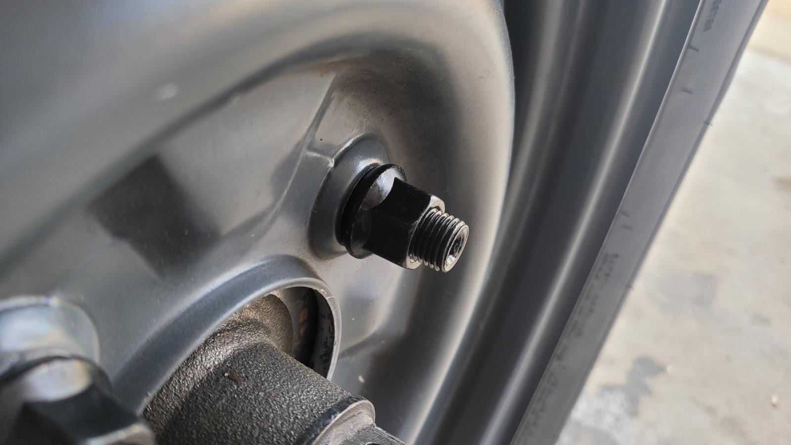

Here are the nuts I replaced them with. They are a ball-seat design.

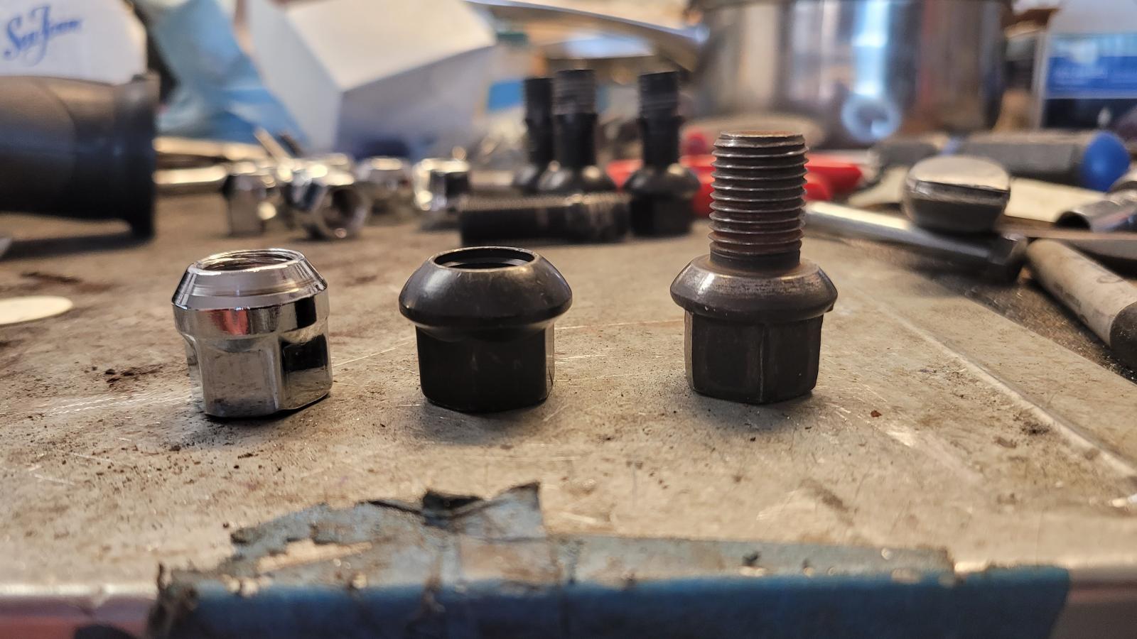

Here is the "wrong" nut, correct nut, and stock bolt.
