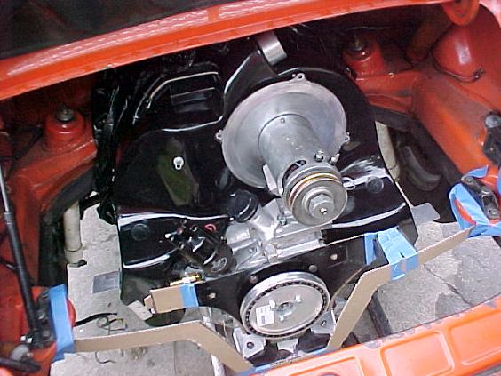

here's a picture of mine: (if the link works)
or click here:
http://www.912bbs.org/index.php?a=thread&p=96422

914 Ghost...
DO NOT use that upper alternator pulley!
It is from a 356/912 engine and will send the cooling fan super sonic with the lower pulley that comes with the DTM. This will probably explode the cooling fan and wipe out the entire top end of the engine and shroud as it is very violent when it happens.
Use a stock Type I alternator pulley!
